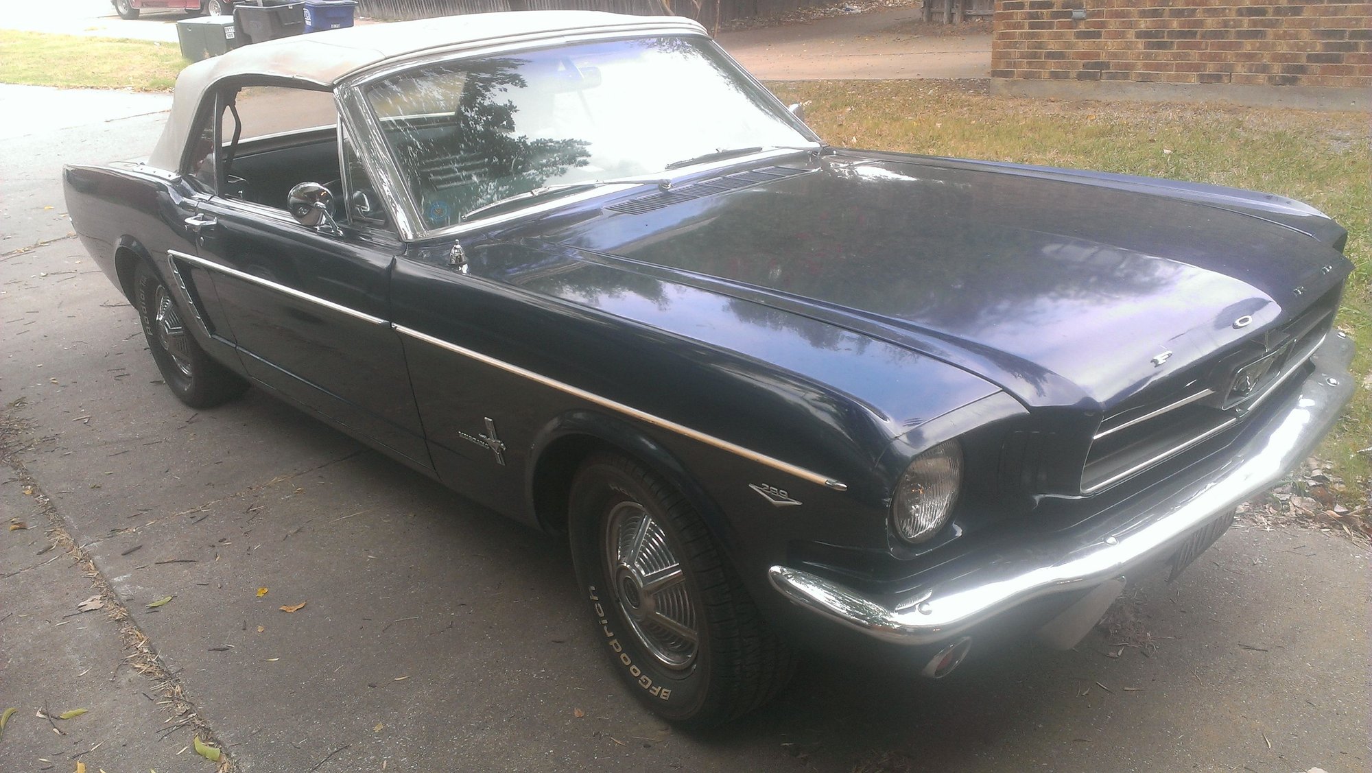

I recently inherited my grandma's '65 Mustang (289, 2 barrel). She runs fairly well (sounds good, no rattling) but is really lacking power. I'm almost full throttle accelerating to normal traffic speeds. She also hesitates a ton when I hit the gas.
After doing some research I replaced both fuel filters (one on the carb and one in the fuel pump). I also replaced all of the spark plugs and plug wires. She maybe feels slightly better, but not much. If I'm at a stop sign and turn right onto a major street (speed limit 45) I have to really hit the gas for quite a while to get up to 45. And when I do hit it, she still hesitates a lot (both from stop and while moving).
I guess the next step would be to rebuild/replace the carb? Anyone have any other suggestions?
