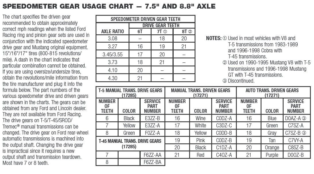

I see Mustangbarn has available a whole series of drive and driven gears as do many other suppliers. and different driven gears can be used with the a single drive gear.

The second link, will work great !
I can get the color of the driven gear, look it up on the chart to see which drive gear it would be. Then figure out which driven gear I need
Thanks, that is exactly what I needed !
Chances are it is a 18t and I need a 20 t
