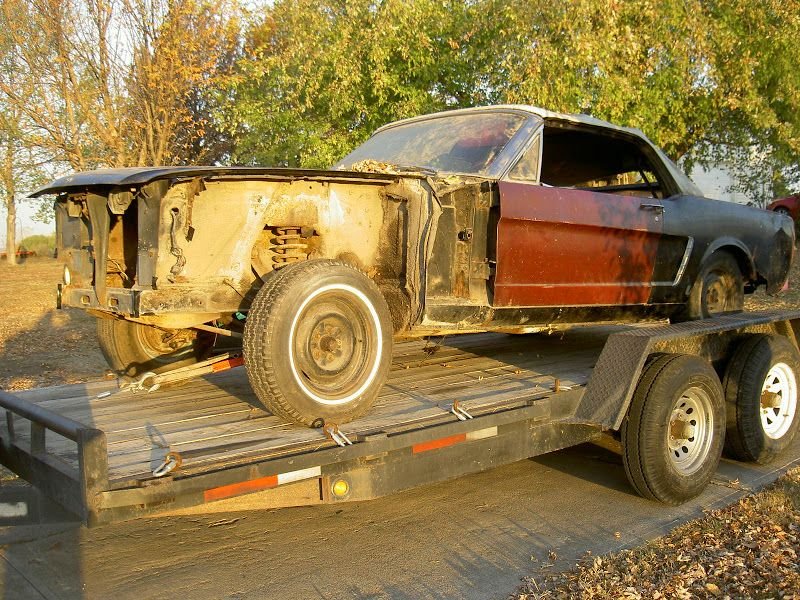

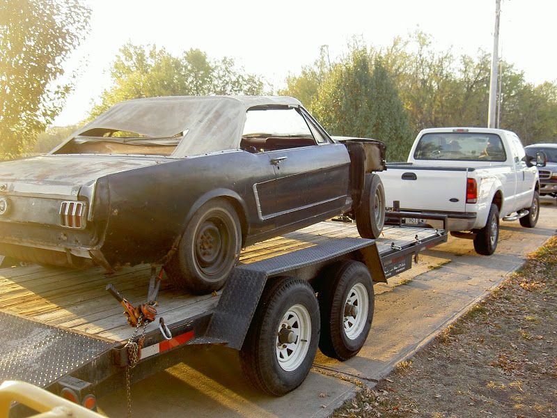

  • 1965 Mustang Convertible C Code/2bbl chassis that is almost rust-free that I bought local for around 2k! I sold the original engine and 3 speed transmission that needed to be completely overhauled anyway for about $500

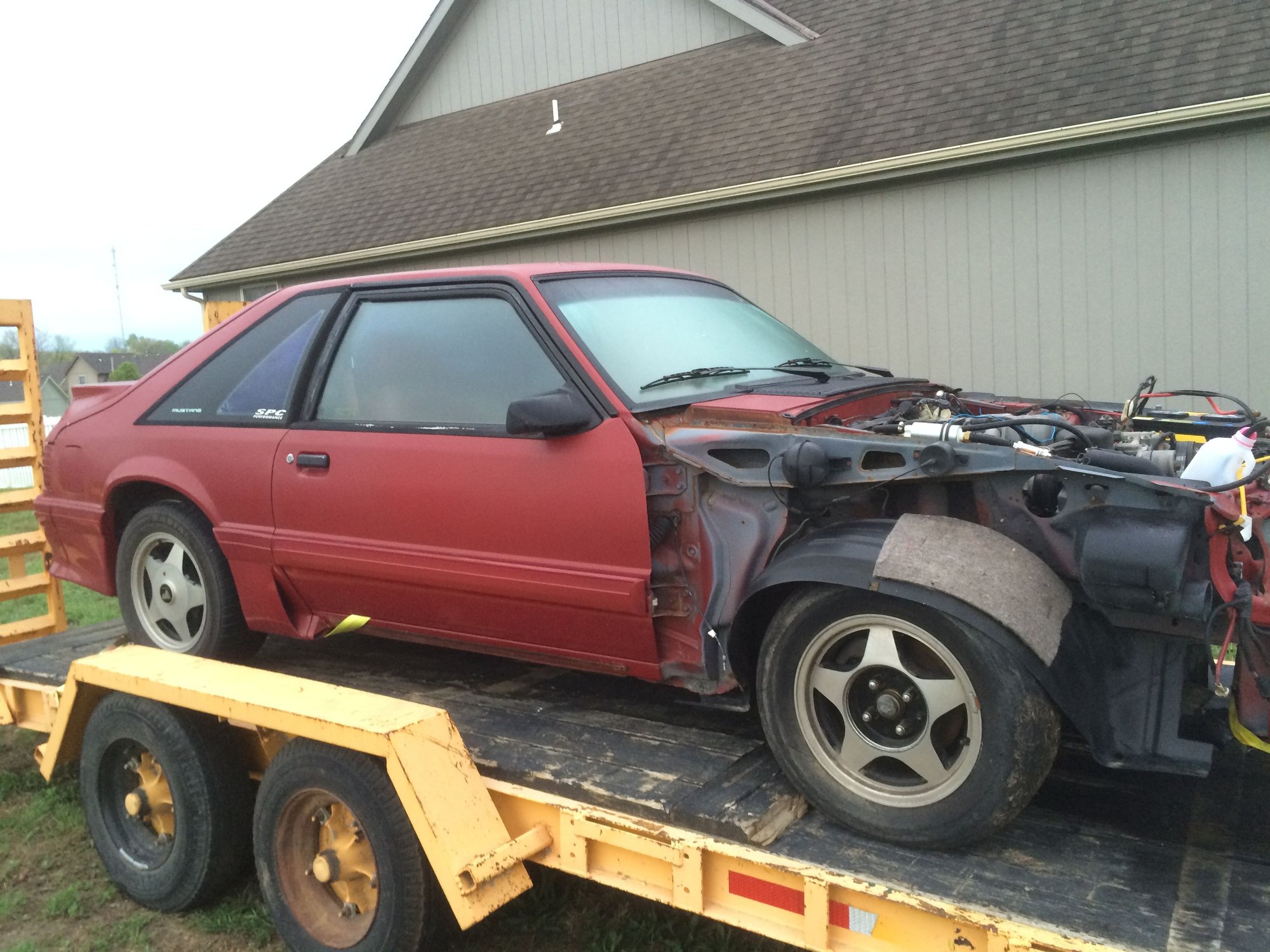

  • 1989 Mustang GT (wrecked): I found this Mustang on Craigslist and bought it for $700. It's got a running engine with 80,xxx miles. T5 transmission, good exhaust, all of the systems are untouched. I'd love to transplant as much as possible into the '65 convertible.

  • Rust repair: Although there isn't any extreme rust damage, I've found some structural rust damage on the front driver's side torque box. There may be some on the rocker panels, cowls, etc. I don't have equipment to sand-blast, but maybe I should look into some equipment for this. I need to find out what's rusty and start saving some $$$ for replacement parts.

Default Pictures

Default 1989 GT Mustang 5.0 EFI T5 Donor
