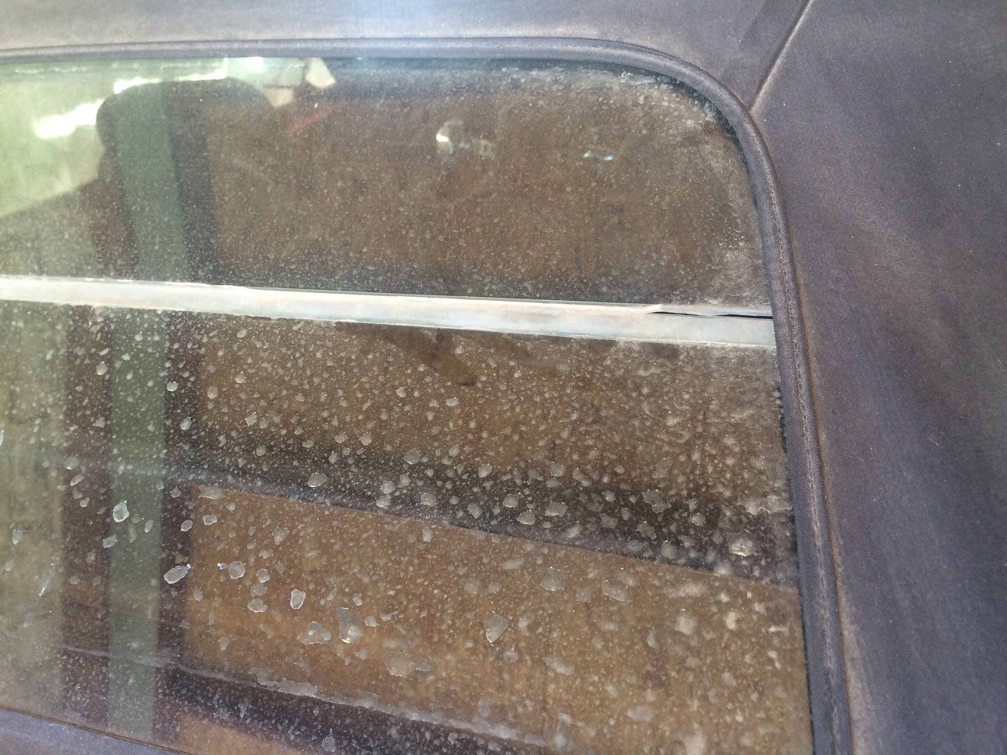

This is the the rear window on my 69 convertible . It's a two piece glass binded with a glue/silicon in the middle of them so to help fold when the roof goes down. It's starting to peel and not sure how to fix it.

new glass or plastic window

Wonder how old the top is? There was a time when companies used folding glass. That connector or seal is a normal part for the glass. Plastic windows don't have that seal obviously. Find a company that deals or specializes in convertibles. They should be able to get you a new seal.

My brother had to do the same thing on a car he has. He took it to a convertible shop and it was about 200 bucks

...and I think it's one of those headache projects where it's easier with less hassle to pay someone to do.
