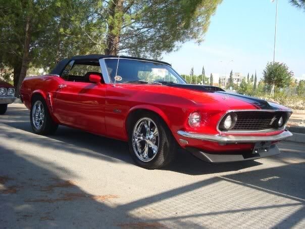

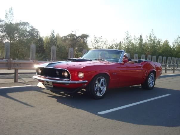

Here are some pics of my 69 vert. 17's all around
