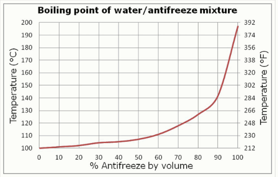

Increasing pressure increases the boiling point of the coolant
The boiling point of the coolant is also raised by the concentration of antifreeze.
Adding antifreeze lowers the heat capacity (cooling ability) of the coolant
The engine runs more efficiently when it is hot and the air charge is cold. With a 190° thermostat, some of the coolant will be running much hotter near the cylinder walls. To keep this from vaporizing the coolant, the coolant pressure is increased. This increase comes from the coolant expansion and the air expansion as it heats.
The pressure is a trade-off. A typical radiator is about 20 inches wide and 4 inches deep giving a surface area of about 80 square inches. At 13 psi this is a force of about 1000 pounds trying to push the top tank off and the bottom tank off. Since these tanks are soldered or brazed on we have to keep the radiator cap relief pressure to a safe point where the radiator keeps together but the coolant boiling point is as high as possible. Ford chose 13 psi.
The cap must also allow for air to go back into the radiator as it cools or the radiator and hoses would be sucked flat as the pressure went down. So the cap's ability to hold pressure and leak back are important. Either system can go bad, so it is good to replace the cap periodically.
