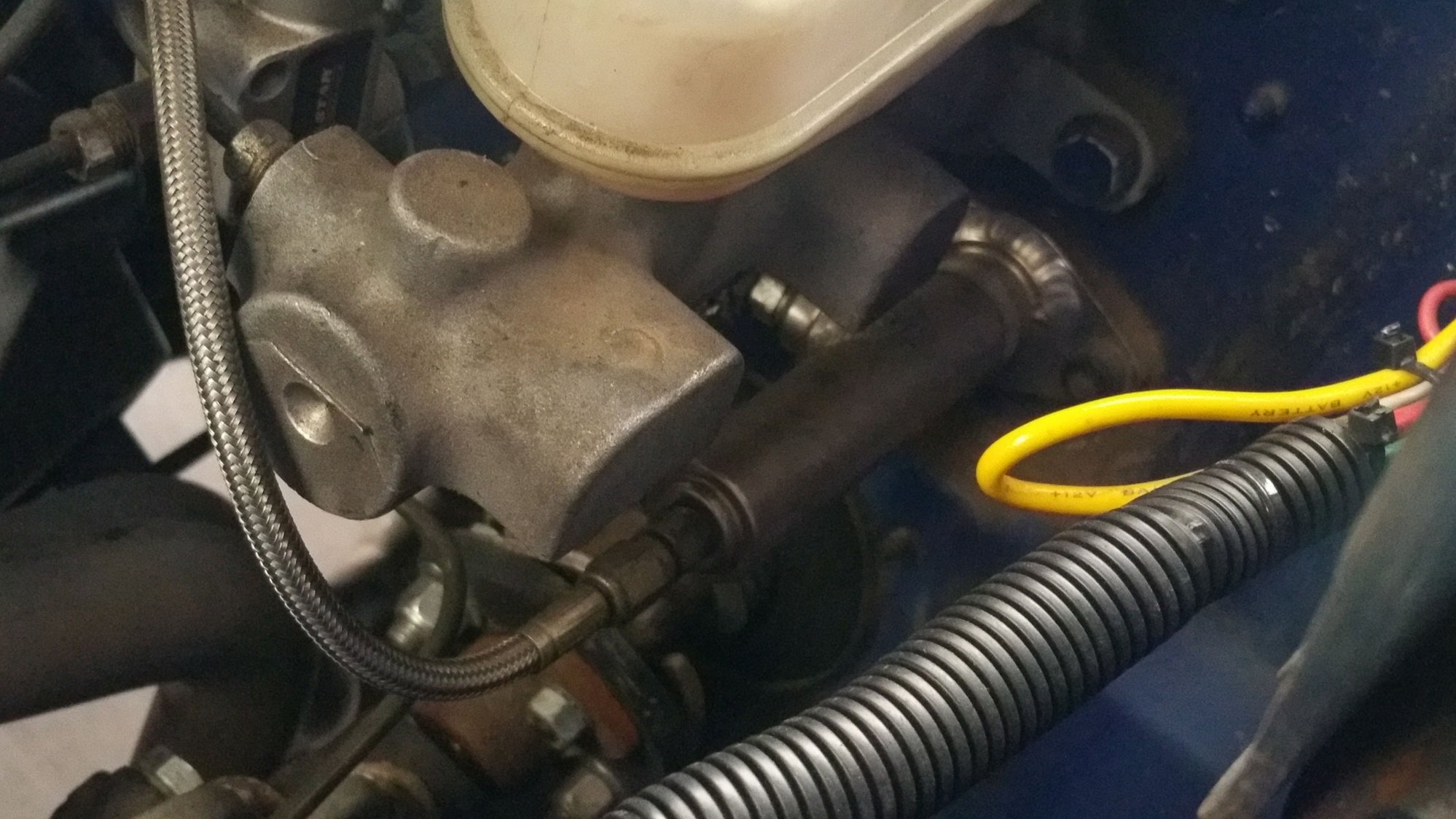

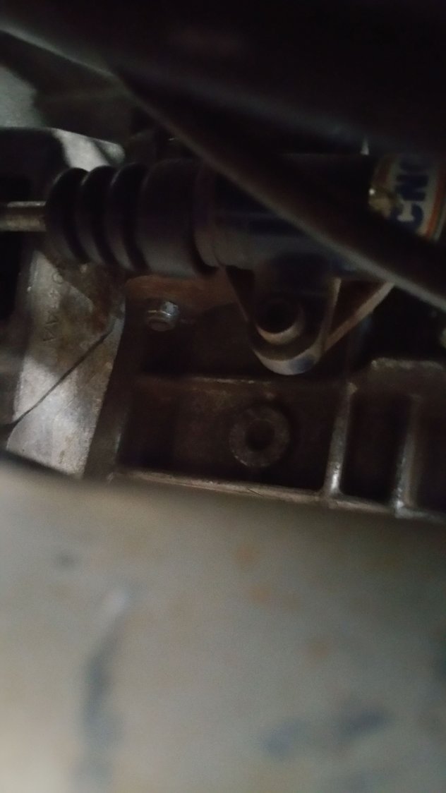

I recommend using the set up i uesd. it can be purchased as a kit or you can peace it together. it will be cheaper if you peace it. it is a VERY compact set up and works great. I have been using mine for almost 7 years now. i will list the main parts here and later post some pics. I am only listing the web links for reference. shop around and you will save. I found a place local for me called Fodderills motorsports that had great pricing.

for the slave this works great. you will need to make or buy the mounting bracket. there are forum threads where you can also find all this info. this is how i learned it. fromthis site on previous links years and years ago.
http://cncbrakes.com/sc.asp?grp=sc&s...305&subseries=

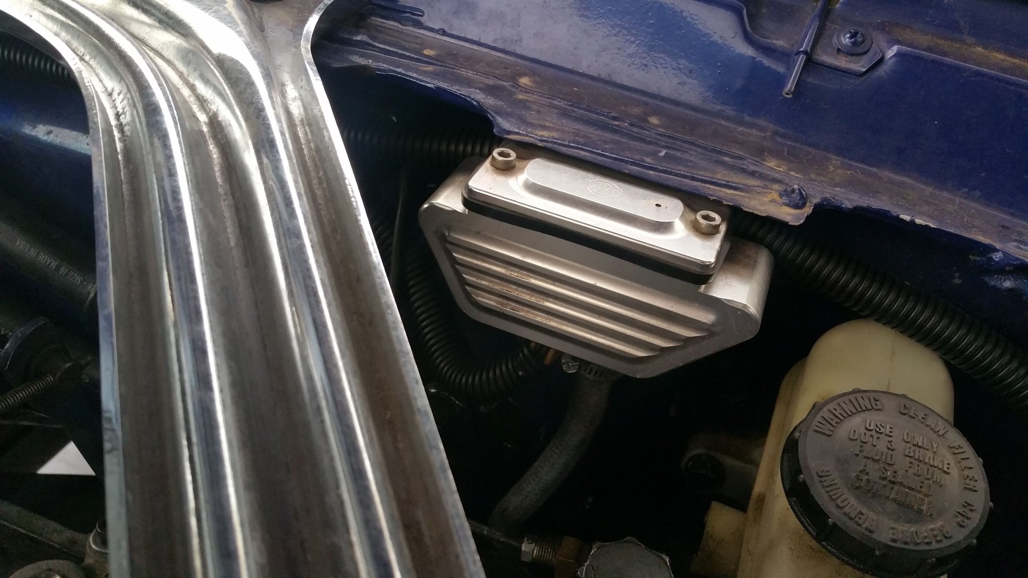

For the master, use a 7/8 bore. Also i had to use a remote resevoir which i picked up from a custom motorcycle shop. and for the mounting of the cylinder, use a header flang for the inside of the firewall. the hole is the right size and the bolt pattern matches.
http://www.cncbrakes.com/mc.asp?grp=...711&subseries=
