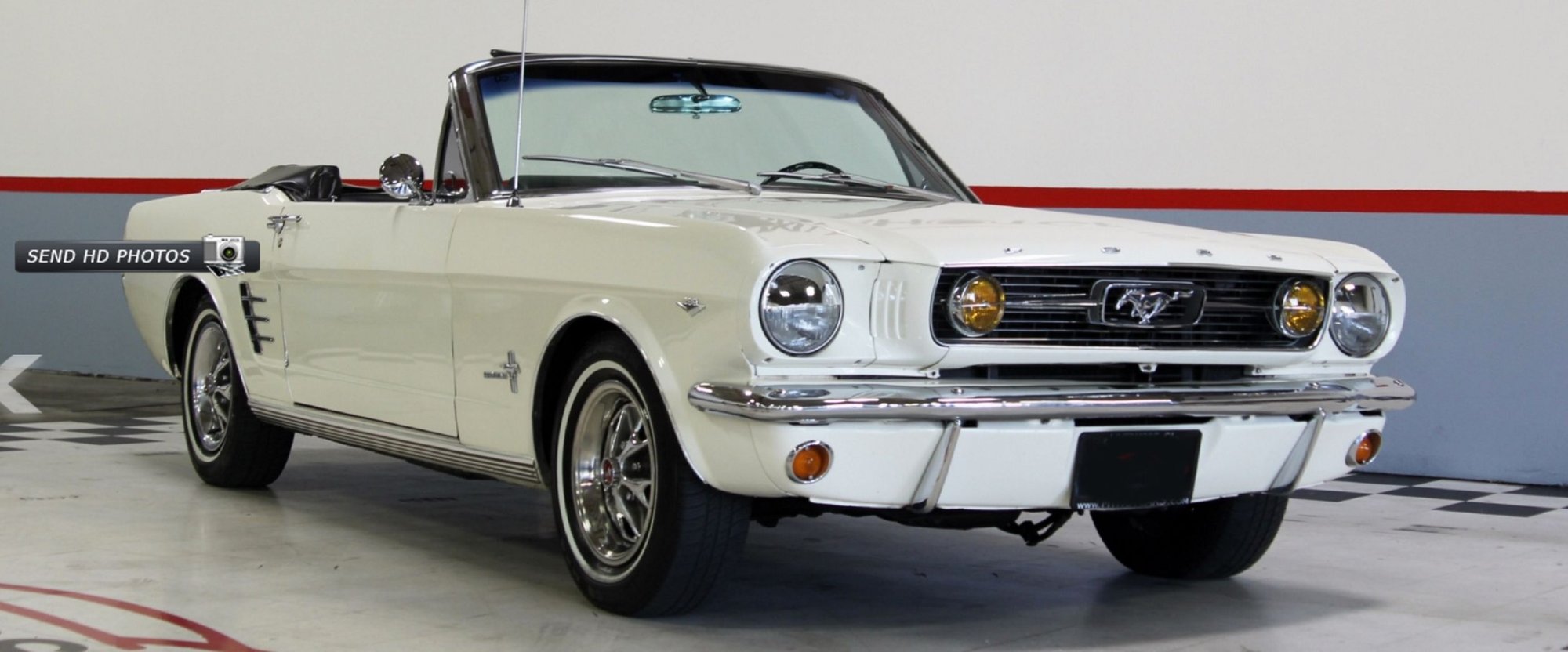

I'm looking to buy a 1966 Mustang and had a compression test done. Bellow are the results:
CYL1 -105psi
CYL2 - 100psi
CYL3 - 90psi
CYL4 - 100psi
CYL5 - 130psi
CYL6 - 105psi
CYL7 - 95psi
CYL8 - 95psi
any feedback on this would be greatly appreciated... is it low? should i be concerned of the ratio from 130psi to 90psi??
