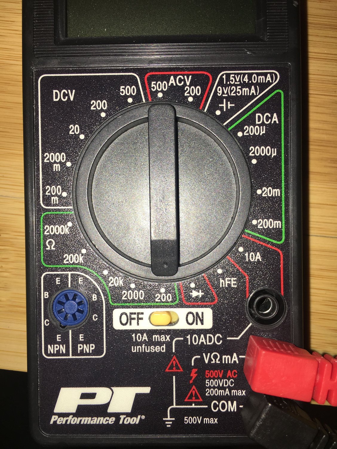

I want you to give that solenoid a few good hits with a rubber or similar type mallet and see if that frees up the contacts...take a before and after reading.. If the contacts free you should see very high resistance (it should read the same as air) If hitting it changes the resistance to very high you can be certain its a solenoid issue. (although I cant think of anything else unless its being pulled closed by a bad ignition switch. You can pull the two small wires off the front (one to coil and one to key) this would isolate the ignition switch from the solenoid

This is how I have been running the tests, hope I would be doing this correctly on this setting right gun jam? You've been a great help!
