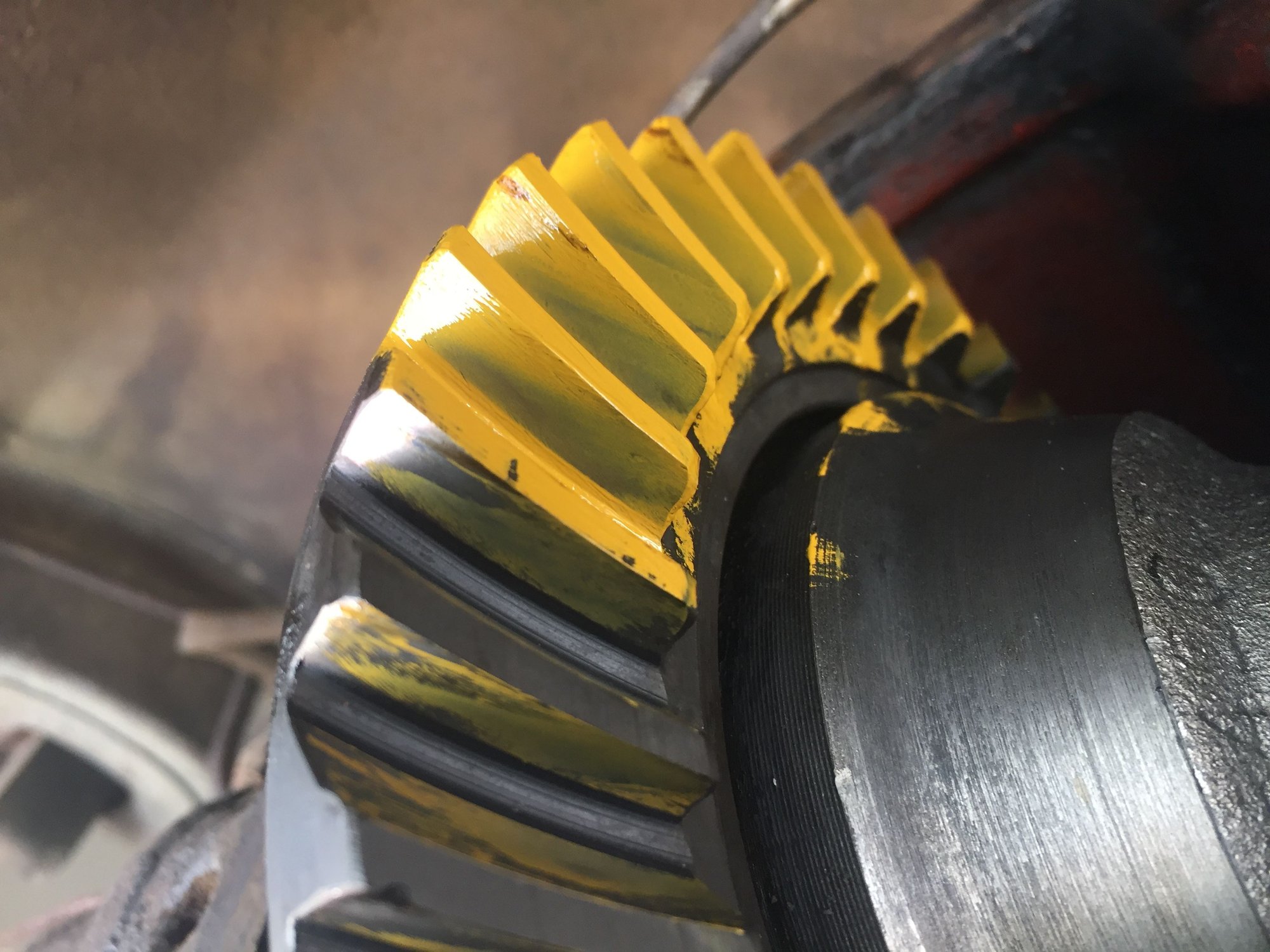

Well got it back together and it runs very well, super smooth and quite on drive and coast side.
I went for largest tolerable level of backlash between 11 to 13 thou book calls for between 8 to 12 thou.
I went for highest amount of pre-load at 3 notches past contact. book calls for 2 to 3 notches.
Checked backlash like 4 times and each time I had the tool setup proper I got consistent readings.
Pulled the Drive shaft and checked for resistance....yes the pinion still has noticeable drag, feels pretty smooth (not noticeably worse than the new bearings) and no play can be felt or heard.
checked coast and drive contact and I guess its alright **** I dont know it kind of matches the patterns in the book but there isnt anything I can do about them anyhow without screwing up backlash and I never touched the pinion.
Found the paint marks and lined them up.
hope it stays fixed. It sure is a hell of a lot better sounding.
