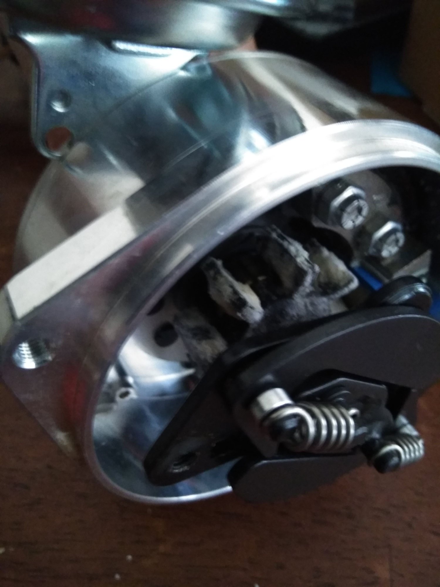

Hey is this white powdery oxidation anything to be worried about? There was an invoice with the distributor, it looks like it could have been sitting awhile. I read that this is due to moisture that can't escape the distributor? If what I'm reading is correct it's no big deal. Can a hole be drilled in cap to vent moisture?
In this next one I tried wiping off the oxidation, the magnets or whatever they're called look fine.

I would brush it off with a soft brush of sorts and go about your business.
You'll need a good timing light now and probably advance spring and bushing set. I bet that bad dog isnt all in until like 3500 with those springs 2000 to 2500 would be better

Once I brushed off the magnets, I saw no signs anything would be wrong. It came with a red cap, which I didn't want, so I painted it today. Prices are high for msd caps! I did a vacuum canister test today to see if everything actuated correctly and it looked good. I will certainly get a spring kit to dial everything in once that time comes. Now I am on the lookout for a low priced 6a or 6al2 ignition controller and good quality coil too.
