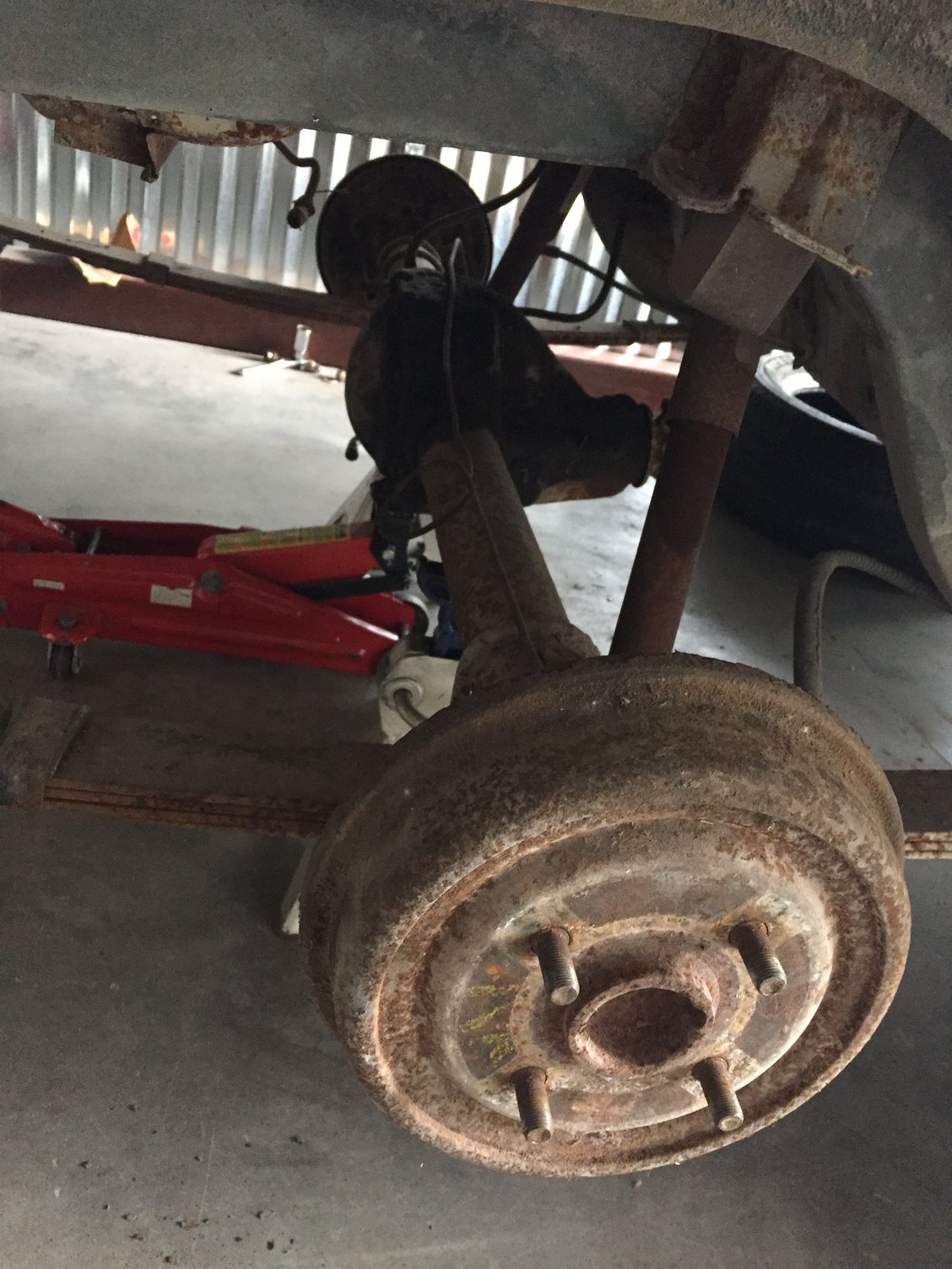

My mustang project differential is a four stud differential but I believe they are supposed to be a 5 lug, my car is a Frankenstein car too since the front spindle was from a 77 granada.

Yeah that is odd, after 68 any 6cyl mustang came with 5 lug. So I guess it could be possible they swapped in a rear end from a 65-68.
That front end you have isn't that uncommon, the Granada swap is popular to get disc brakes on the classics.
