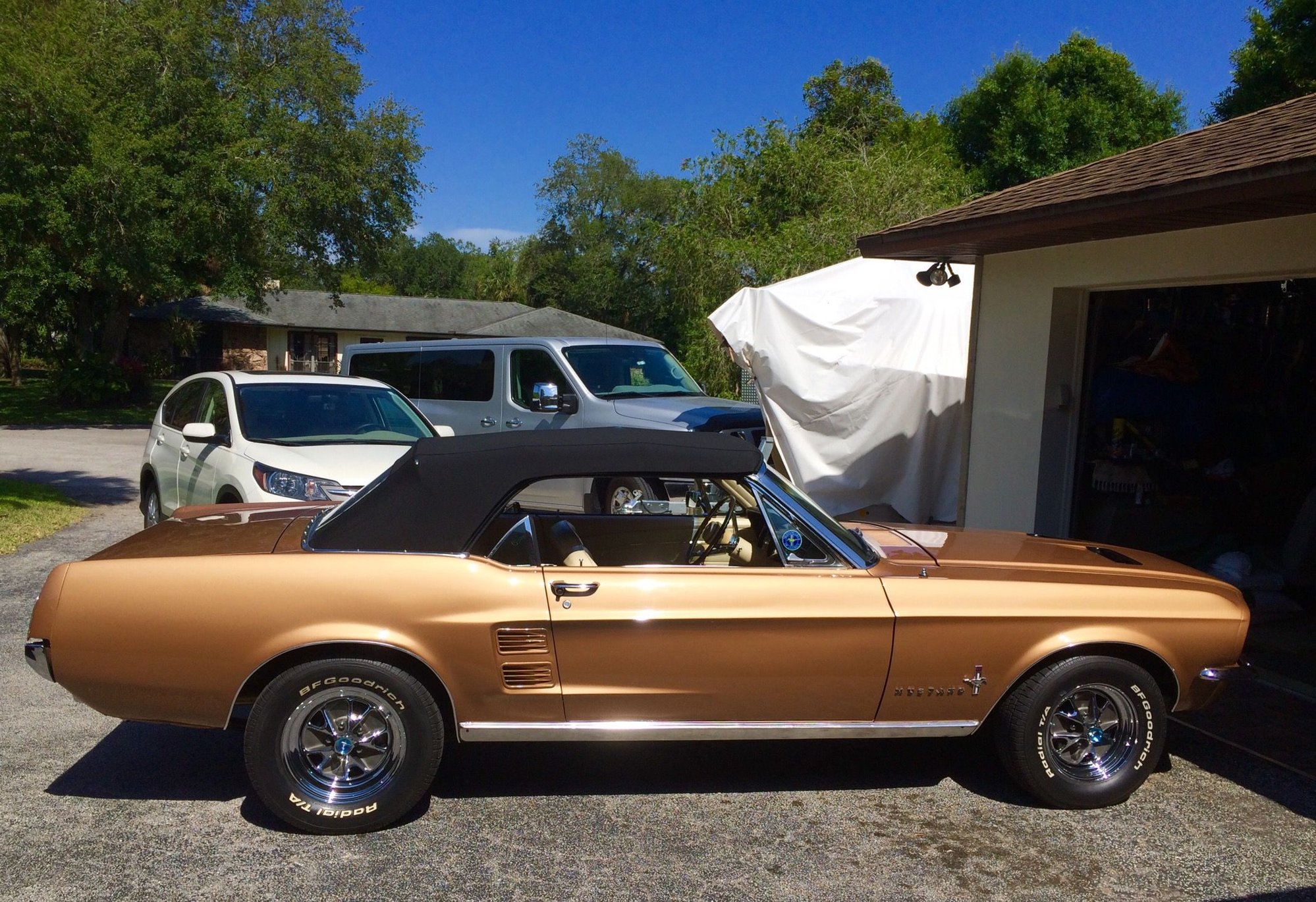

the other thing you can do is go to car show and look, guys might not know the back spacing , but you can look at tire size, How clearances are and rim sizes. Generally bigger rim sizes give you a thinner side wall. My opinion is thinner sidewalks give you a more modern or resto-mod look., wider sidewalls are more old school, stock look. Wanted the old school look on mine 67, but because there are more size options for
15 in rims, I went with 15's on the back and 14's on the front. ( you don't have to worry about rotating them either!!) I think the look cam out pretty good, and if you don't know, most will never notice the two sizes.
