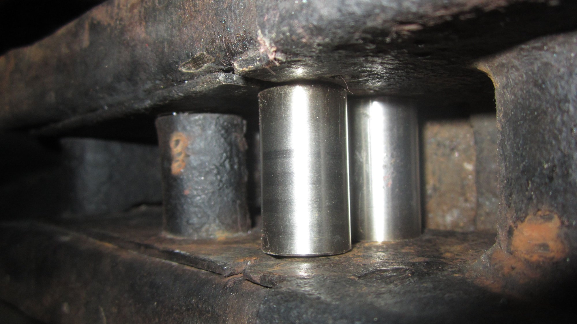

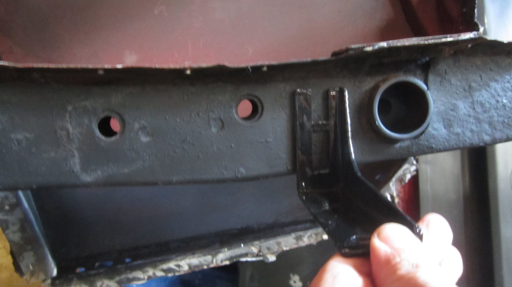

I have the tank and trunk out. Was thinking of drilling and reinforcing the frame rails to mount gt exhaust. Does anyone have the exact location for the mounts?

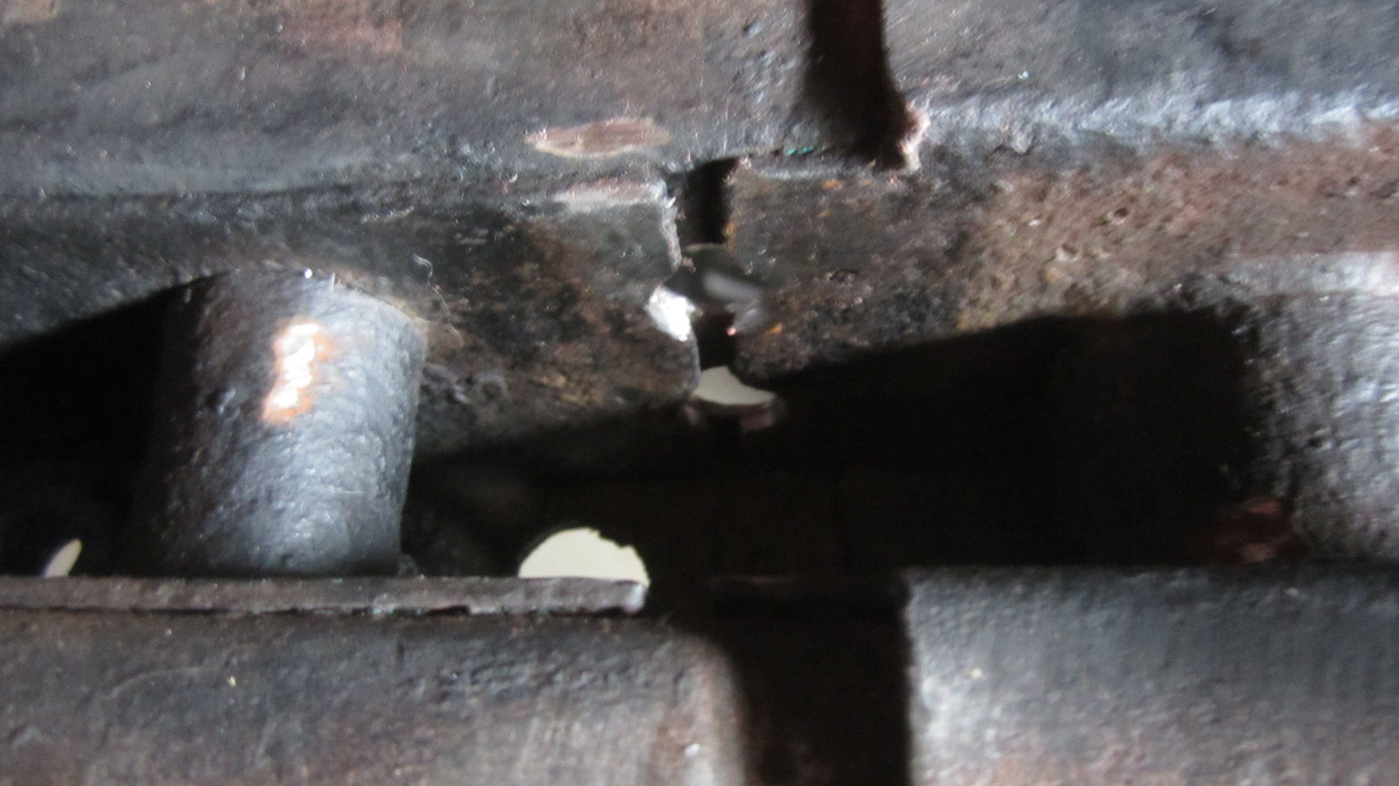

I case anyone else in the future wonders about this. The holes are where the 2 reinforcement pieces have a gap in the frame rail. (makes it a pain to drill) I have 303 stainless tube from my work that I will tack in for reinforcement.
