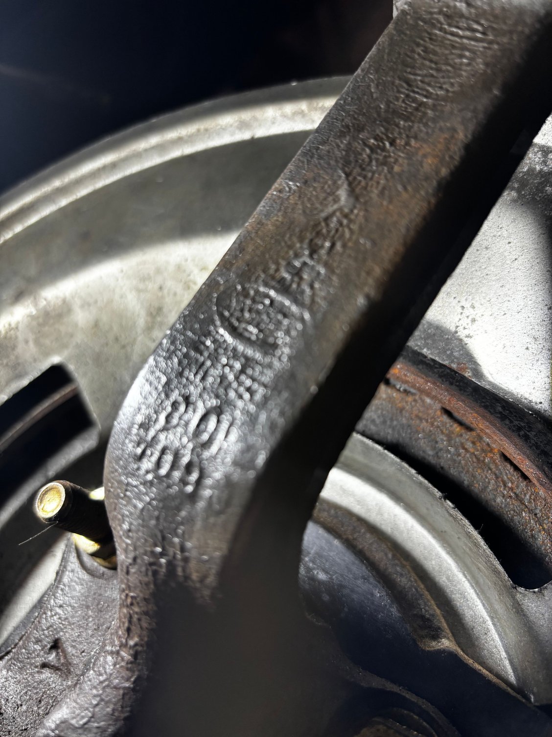

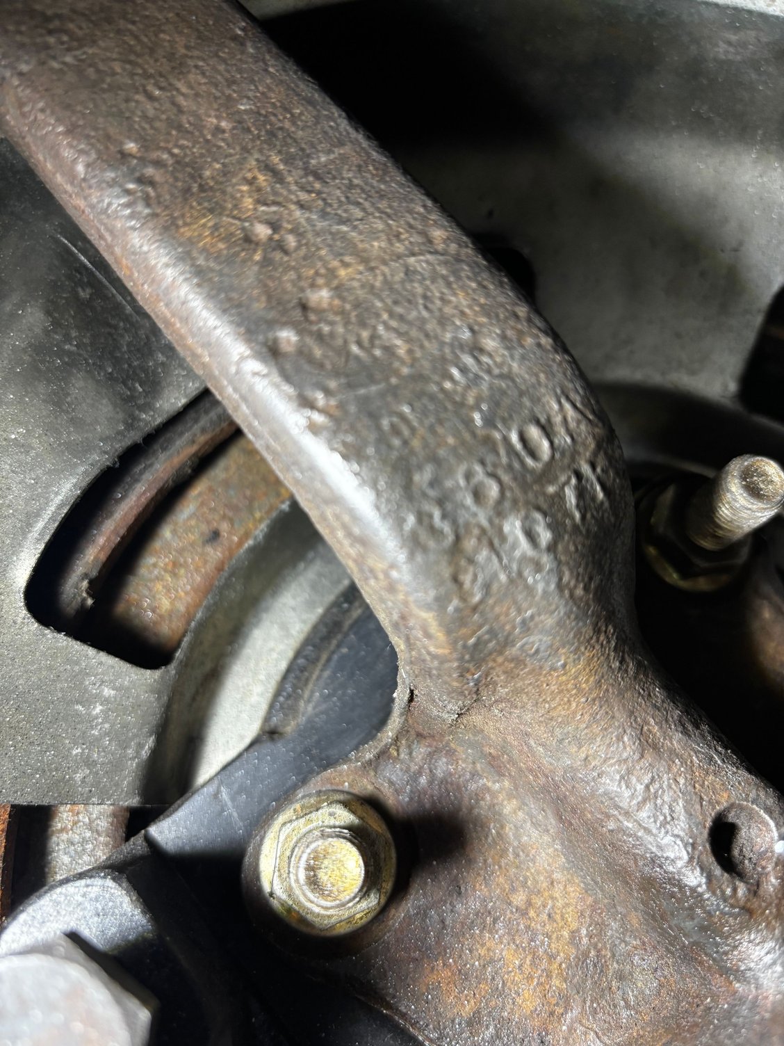

PS: previous owner installed a front disc brake kit of unknown make.
Steering spindles do not appear to have the 3105/3106 part numbers for Mustang spindles, but they aren't really legible either, see photos

I had to replace my '68s' steering box for the very same reason, just last year!
Probably a Ford Granada-like disc brake kit - I put one on both my '68 and '66 Mustangs, but I changed over the entire 1966s' six cylinder system to V8 all at the same time - including the new disc brake kit.
I believe that the spindles DO have different diameter holes, but it would be worth investigating what you've got,...since you have 'mixed' parts. Perhaps your spindles can be machined with a larger Morse taper, if necessary (?) - I don't recall how much metal there is,...
The cars will accept either system, without alteration, but you can't 'mix and match' between the six, and eight, cylinder systems. One is thin, the other 'beefy',...
Very best of luck with your car!
