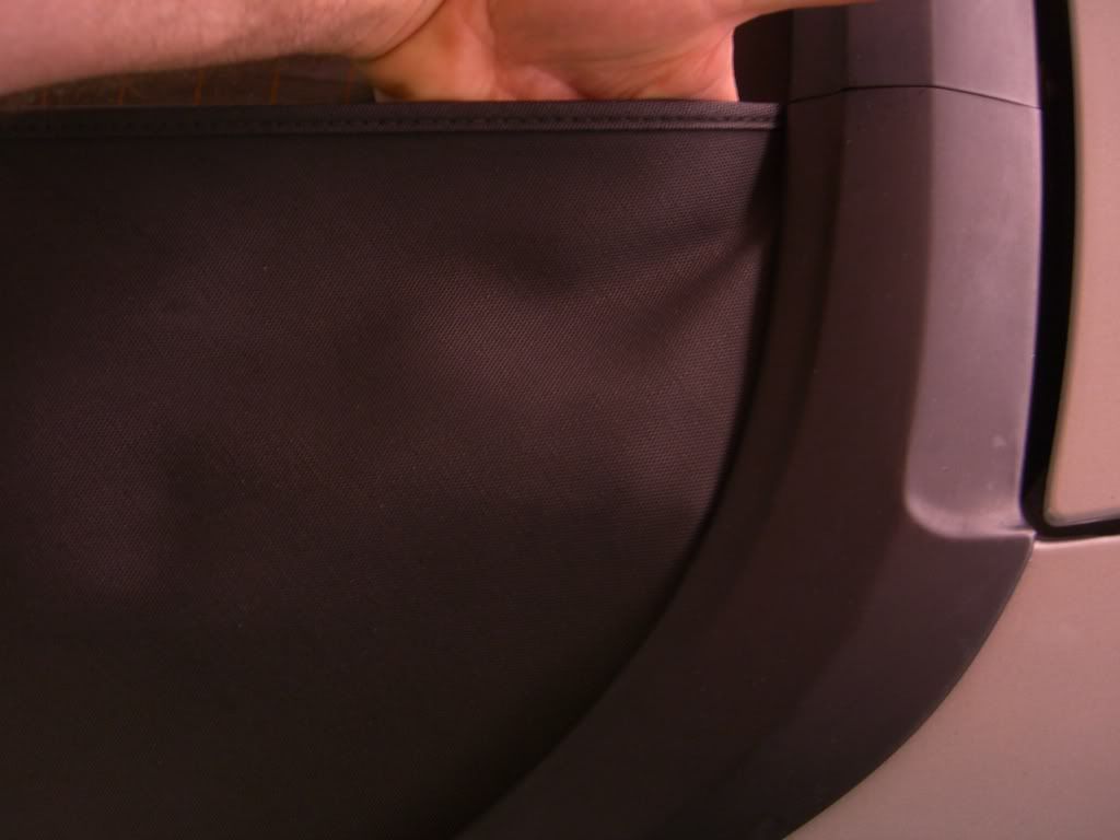

On either side of the back window, in the bottom corners, one or two wear holes will be present that allow the water to enter from the outside when it is present. The holes are difficult to locate (This is difficult to describe without pictures so have a look at the attached images as you are reading this) -
From the outside- Stand beside the car in front of one of the back wheels, facing the car. If you look at the rear glass you will notice there is a fold of material between you and the glass, slip your hand into it and slide your fingers down into the corner nearest you - feel around and you will find a small how about the size of a pea, possibly larger - that is the culprit. Look at the images below for a shot of where your hand should be.
This is where your hand should be:
http://i261.photobucket.com/albums/i...t/CIMG4762.jpg
