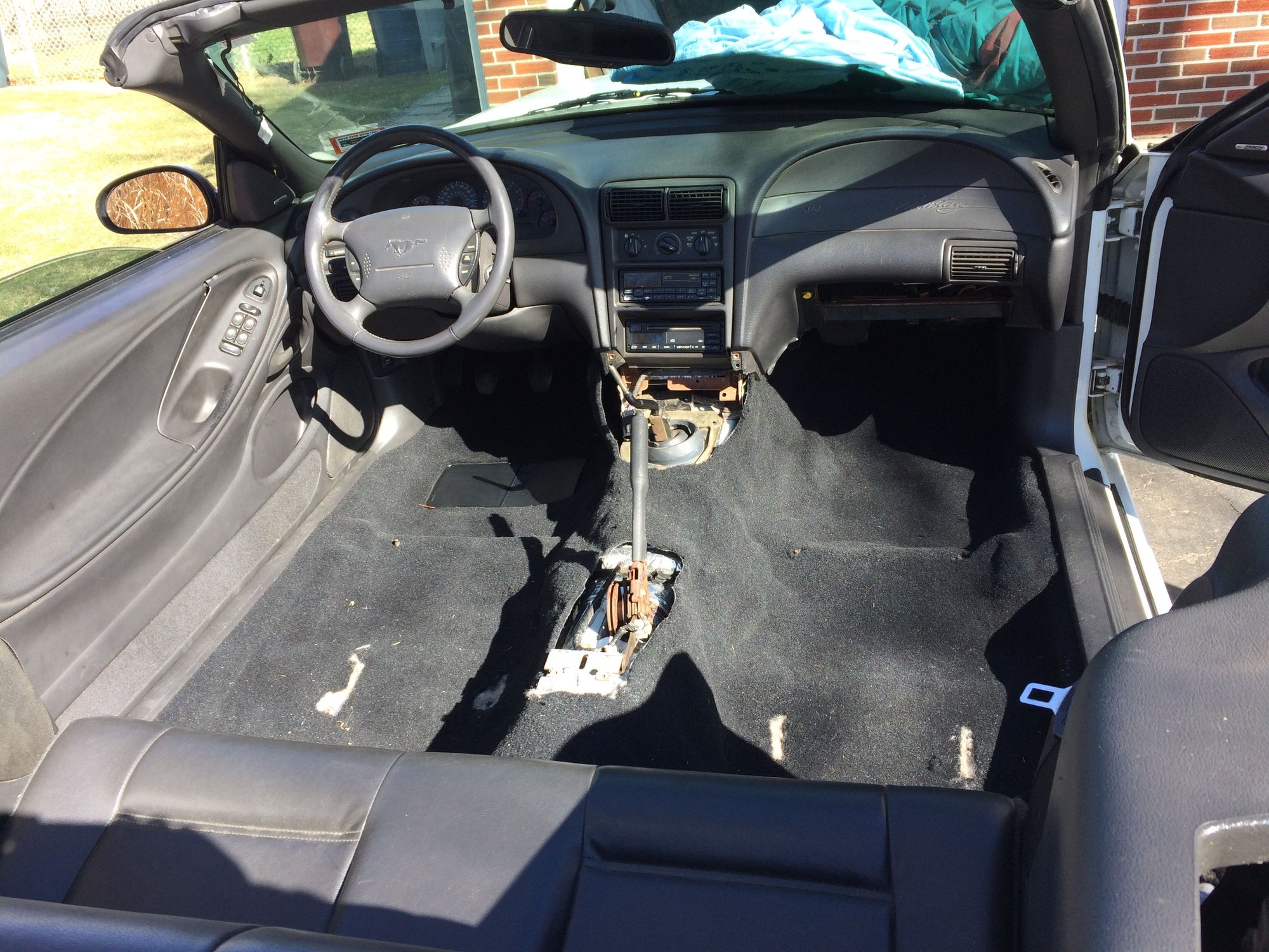

Thanks you all everyone's replies with assistance. Finished... replaced the motor but I tracked it to the emergency brake latch. The connections were making the motor seem intermittent. In reality, my original motor may have been working fine. After cleaning the contacts to the latch, it worked fine.
Now the new carpets have been trimmed and the interior has been replaced with newer, cleaner panels and seats. Since, the original was a mess, this restore worked really well. Newer/excellent convertible frame, hydraulics, vinyl top, liner, speaker covers, door panels, new carpet, front and back seats, rear brake light, glove box along with chrome rims.
