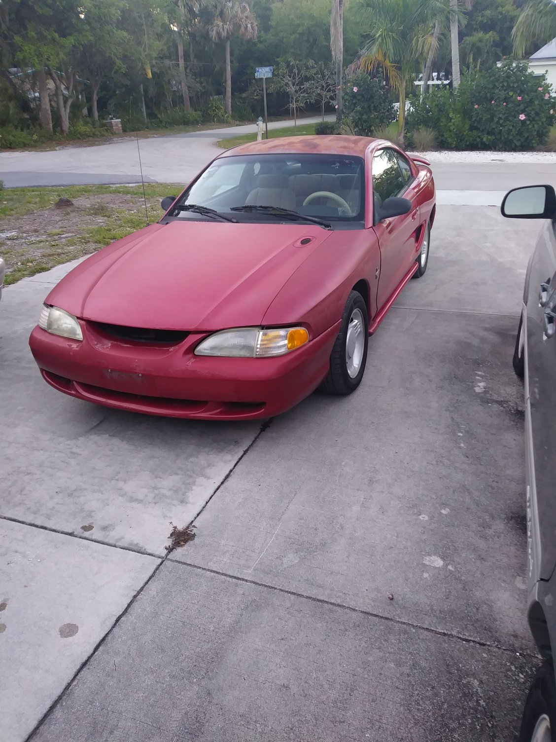

i would have left it stock but i saved this car from the junk yard gave it a second life. When i got it the roof was rusted rear passenger quarter rusted mirrora had dry wall screws holding them on head lights where zipped tied in due to the header panel being busted and the tail lights looked like someone smashed them with a bat...
Never the less i didnt want to see it go to a junk yard.

Default Before and after

I hate seeing cars rotting away in junkyards. That poor clear coat! It's looking better already. Well, hopefully that harness takes care of the light issue.
