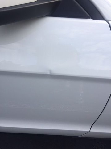

On another note.... I park AWAY from everyone on purpose, I got this lovely gift yesterday, They obviously **** and drove off...
