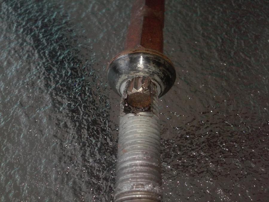

First of all, this is the bolt:
This is where they go:
Those are all loosened up from the last time, but tight they're recessed into the knuckle, so you can't cut them out.
So, I drilled a hole at the center, it went off center, but was able to get it deep enough to pound in another triple square, one size down:
I heated up the bolt, and bearing housing before pounding the tool in. Even if the bolt head would have torn off, that would have
been fine, since the threads would remain in the bearing housing, it would still have come off. That was the plan actually, to
twist the head off so it would still come out with the threads of the bolt in the bearing housing. The knuckle does not have
threads in it, so popping the head off would have worked.
While still hot, I used the breaker bar to loosen it, and thank god, it came out!
