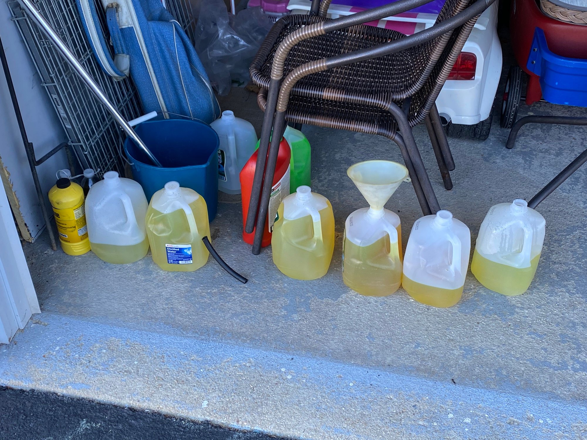

The car currently has 109k on it so I decided to drain and fill the coolant. When I drained the fluid I got what I though was a rusty colored water with a hint of green in it. See attached photo. I could swear that when I check the coolant last it was green.

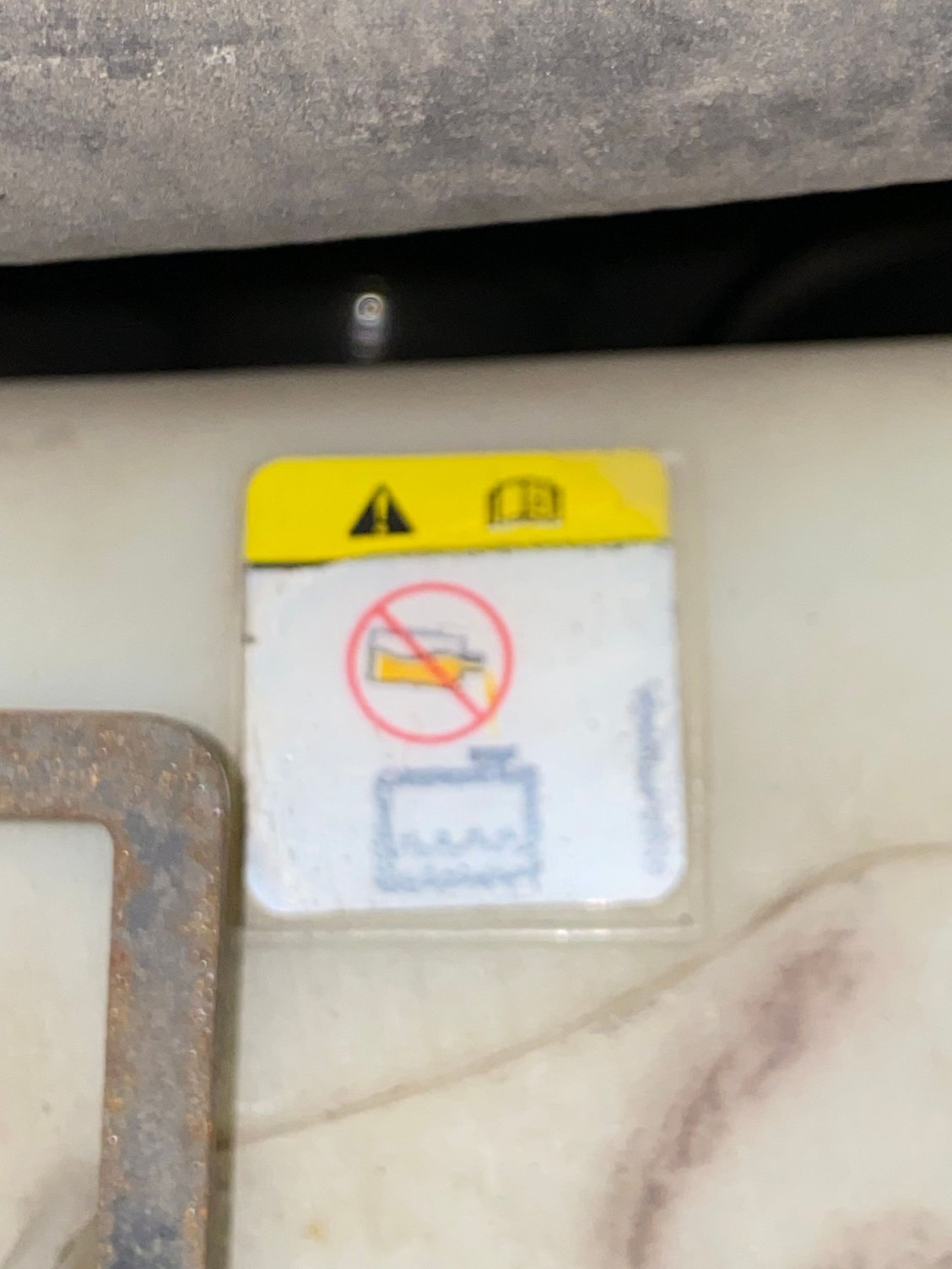

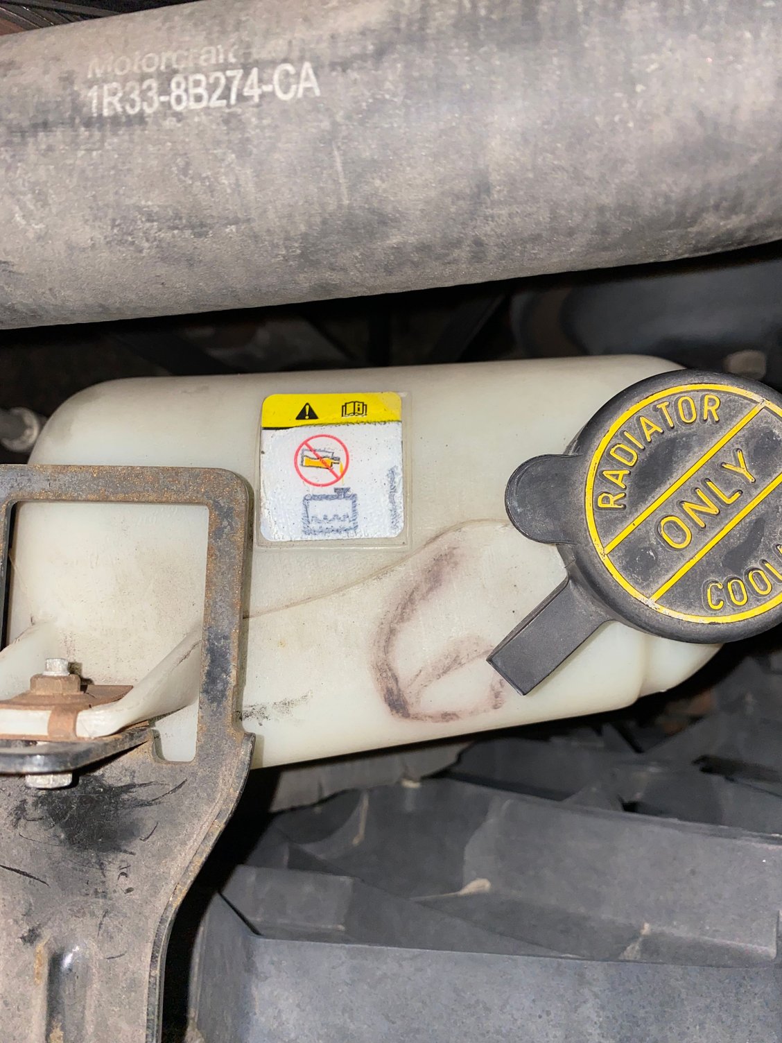

Thank you for the response and all the help on this issue. I was able to locate the manufacture date on the car. The car was built in august of 02 and from the info you sent me the car should use the gold antifreeze as its later then July 15 of 02. Although it’s not that far off, since there is no day on the manufacture date, it could be 2 -6 weeks older and should call for the gold antifreeze according to ford. While I was out there I notice this sticker on the overflow canister. See attachment. Do you know what it means? I assume it’s say not to use the gold Antifreeze but then it’s not saying to use the green either. I’m so confused on this. Any light you can shed on this would be amazing. Thanks again.

When in doubt check with a Ford Dealer but, they will probably refer to the same documentation I already sent. I wouldn't go by that sticker. It can be misinterpreted and/or confusing (like it is) . It could mean "Don't add anything without referring to your owners manual", or don't add just plain antifreeze (meaning mix it 50/50 before adding...who knows. I never rely on stickers. Heck that overflow tank could even be aftermarket or from another car from a local pick-a-part.
