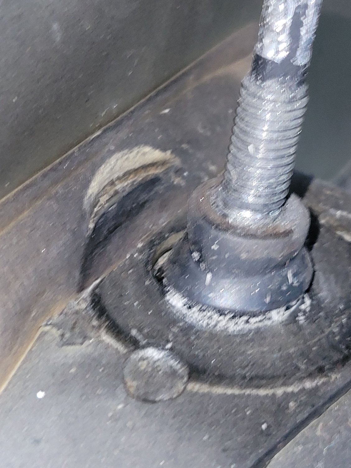

Hi,
I've got a metal on metal noise coming from the rear when hitting some bumps
Things I've done in the rear:
Replaced upper and lower control arms to torque spec.
Replaced Eibach pro lowering springs with new, same model, oriented correctly and wheel alignment.
Replaced rear spring isolators with new.
Replaced rear diff mounting bushing and torqued

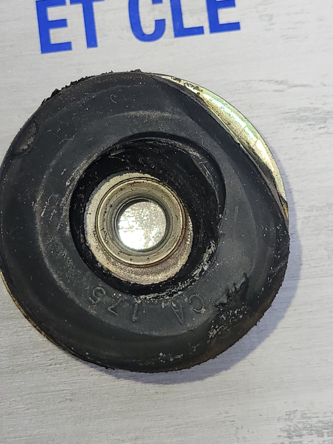

Shock is stock, lower bushing looks like it's cracking a bit..
Would love some advice.
03 mustang mach 1, 86000km
Old Aug 25, 2022 | 04:23 PM
crazyone64's Avatar
crazyone64
Joined: May 2018
Posts: 44
From: Ontario
It was either the upper shock bushing or jack components under the spare tire.
I rotated the bushing so the worn part is nowhere near the wall.
