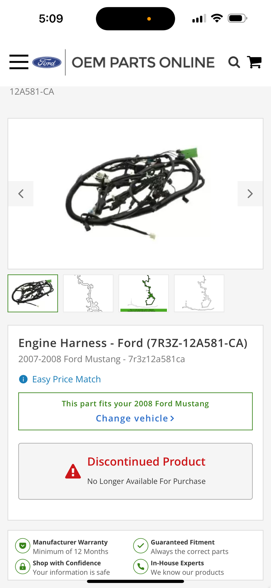

I’m looking for a wiring harness for my mustang but everywhere i look its discontinued!?
how can this be?
any1 know where i can find one?
will one from another year work?
flying blind here. Any help would be appreciated!!!
how can this be?

Something is Not Jiving in The Shop Manual, Not Unusual For The Base Part Numbers To Be Different Than Parts Side. It Should Be A 12B637 Harness Unless Number Was Changed Ford Does Love To Do That. Regardless If There is an Older Number Sometimes You Can Find Them Using a Search For Original Part Number. Pm Your Vin And I Will Run A Build Sheet on The Car Which Will Show Original Harness Number.
Your Number Supplied is a Valid Part Number For 2007-2008 Base Mustang V6 With Auto Trans. Those Are Your Only Plug & Play Options. Beware Online Sellers Who Guess What Years Really Fit! Make Sure Parts Came Off 07-08 Model! We Had Member Over At Mustang Source Recently Who Had an 06 And Used an 07 Harness on His And He Had To Change a Whole Lot of Pin Locations on The Harness To get it to Work. Not Fun!
