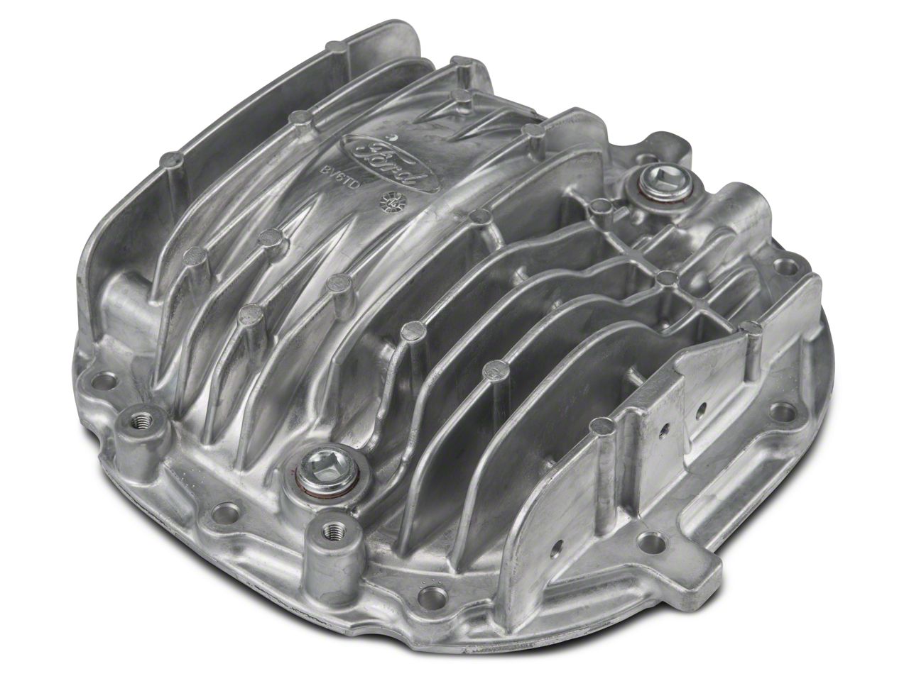

I am looking for an upgrade differential cover for my 2006 GT 'Vert with 8.8" axel. I am mostly interested in a cover with fill & drain holes, not so much in the girdle things. I remember reading these cars need a flatter cover to clear the rear sway bar that goes across the cover. Can anybody recommend a cover that will fill my needs?

Why not go with the 13-14 gt500 finned differential cover?

Looks perfect. I will look into it. Thanks.
