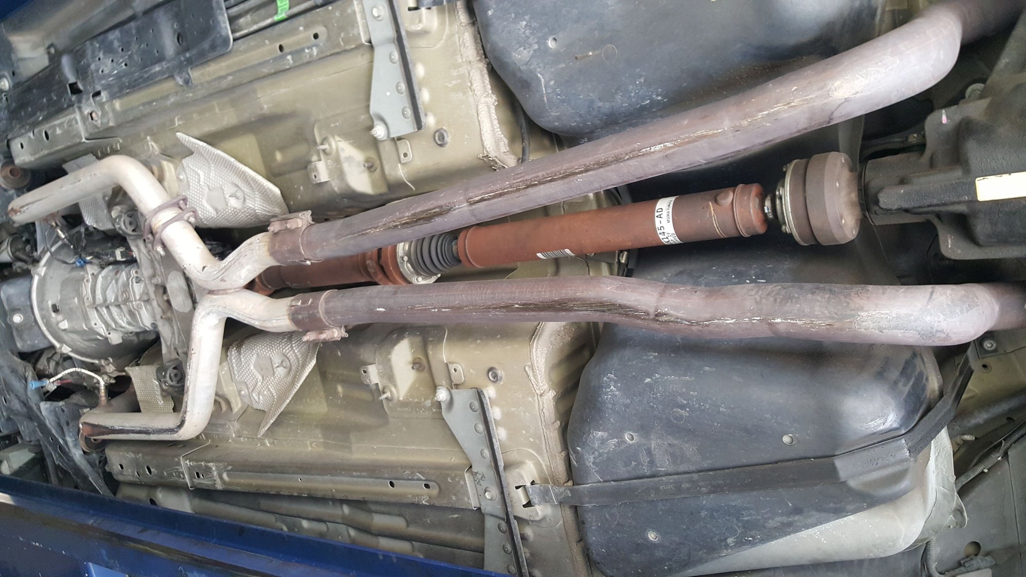

4. Does this look like a crappy Exhaust setup?
Spoiler

Wow. where to start.....buying a modded car without the skills not a great idea. However, it looks like whoever modded this car before you didn't have a lot of skill either. I'm praying for you the guy that fabbed up that cheap-**** exhaust didn't do a cam install.
I'd be a little willing to bet the rear o2s may be still switched on in the tune and it's confusing the ecm (computer). There is NO reason to disconnect the O2s. One can just switch them off when tuning the car if running catless.
The car does look like someone backed over something sharp and bent the LCA mount. Get a cheap set of poly lca like UMI (about $100) because the rubber doesn't look in good shape anyway on these. That is truly is an easy install and will tell you if you are tracking straight. The car will always pull to one side or another, generally to the right slightly under a low traction situation. This is bc of the way the ring and pinion are situated in the rear end. It is normal to have the rear protrude slightly more to the left, (especially if lowered) and that's why people buy adjustable PH bars.

Probably lots of leaks in that exhaust but, if the rear o2s are switched off, it might not be detectable by the engine management. I'd really look at junking the whole mess and buying a decent exhaust, all from one manufacturer. You may end up chasing your tail with the muffler shop one you have. The codes do sound like typical response for a significant exhaust leak though, too lean on the bank identified. There are other causes possible, like the vac leak I identified earlier.

He says my exhaust is fine, that the discoloration is normal due to the type of material in the exhaust and when the exhaust was fitted that the shop might of had to do some minor bending to get it to fit properly. The O2 sensors not a problem if I get a tune.
