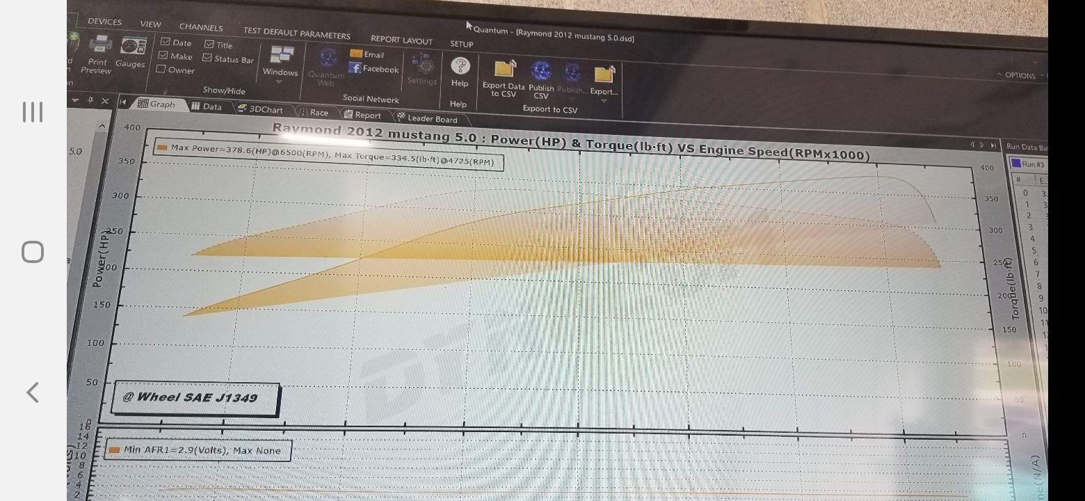

This is what we got.
Can you see that?
I think it low bcuz looking at showroom floor stock 2011s on youtube making more power and Ray's GT has headers and Boss intake manifold.
Which supercharger does the savvy 2011-12 GT owner get?
How about a bottom end grunt Edelbrock?
Thanka you
Can you see that?
Thank you
Your car is an automatic so it has a higher drivetrain HP/TQ loss than a manual, and the dyno curves won't tell you much if the dyno operator doesn't use electronic wizardry to lock up the torque converter when doing the run.
