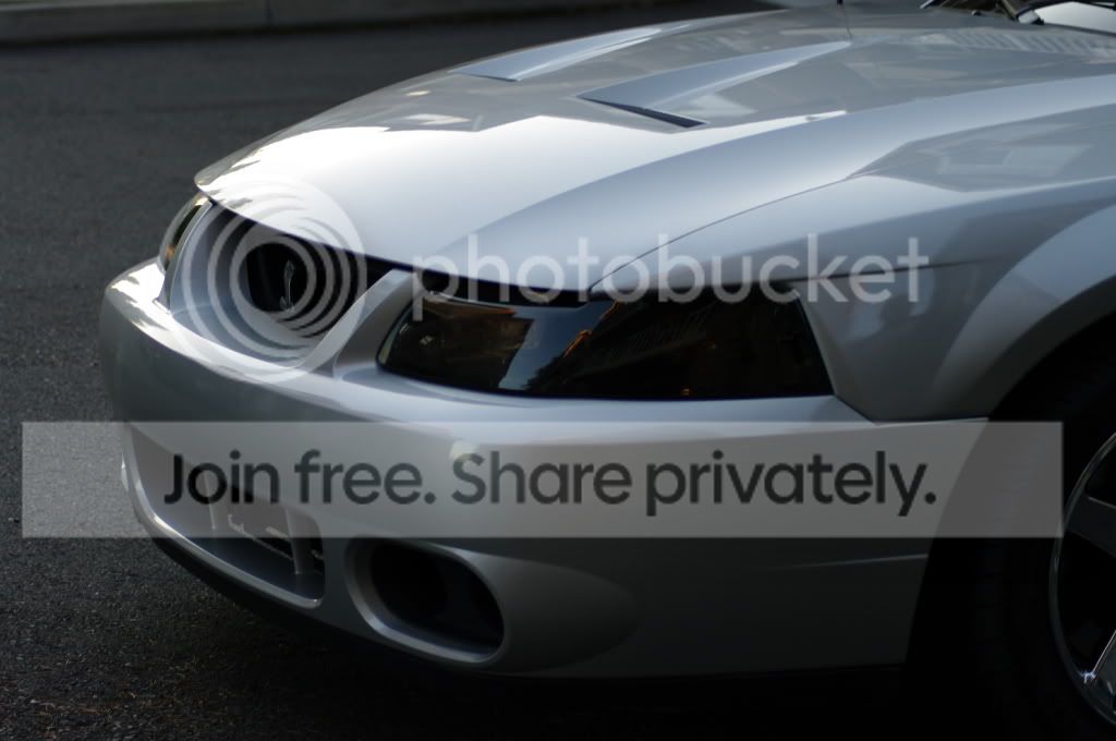

First I tinted the lights and got rid of all the sundried crap that it had. and painted the chrome bumper inserts.

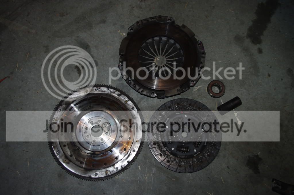

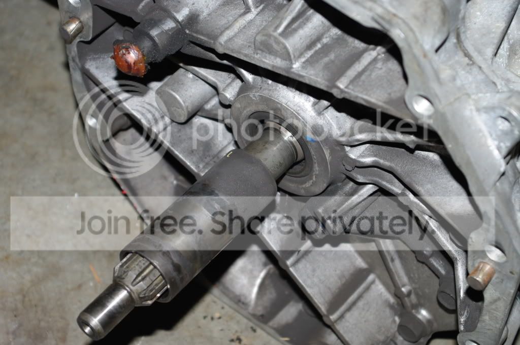

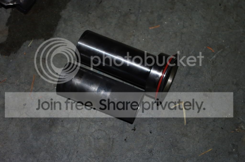

Then took the tranny out and replaced it with a Cobra T-56 got rid of the old clutch, 10 spline input shaft, busted Throw Out Beraing retainer sleeve, and mcleod flywheel. And installed a forged liberty 26 spline input shaft, lightweight ACT 26 spline twin disc clutch and flywheel, Forged LFP TOB retainer sleeve and UPR firewall adjuster, as well as a LPW Diff girdle. SCT tune, Bassani off road X pipe, JLT cold air, 2.76 pulley, Billet Flow plenum, Accufab single blade throttle body and boost bypass was also done.
out with the old

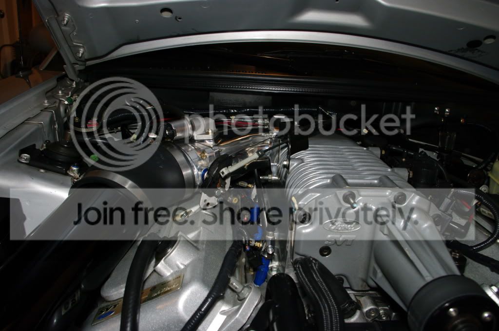

In with the new

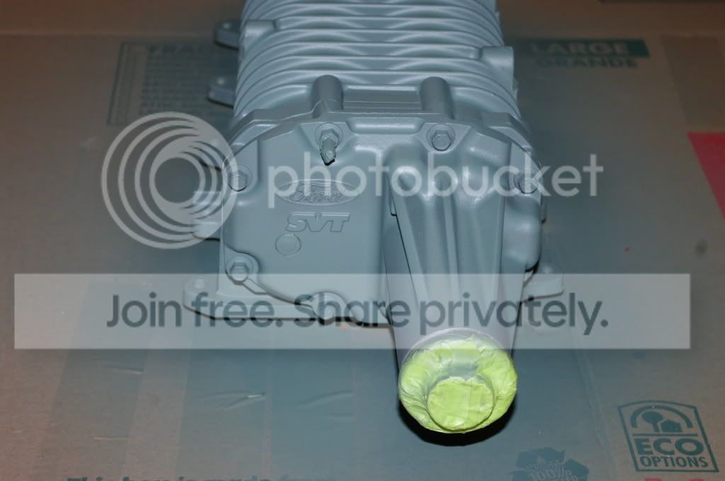

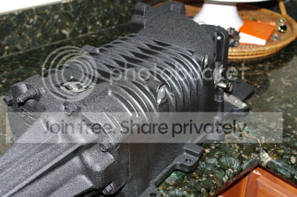

Bought a stage 4 ported blower and decided not to waste my time with it but instead I painted it and sold it.

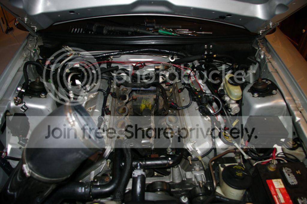

One pic of the motor before I tore into her again

I decided to tear the blower off and install my Whipple

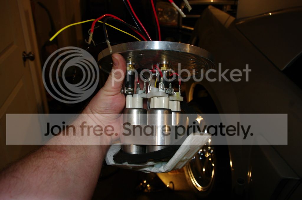

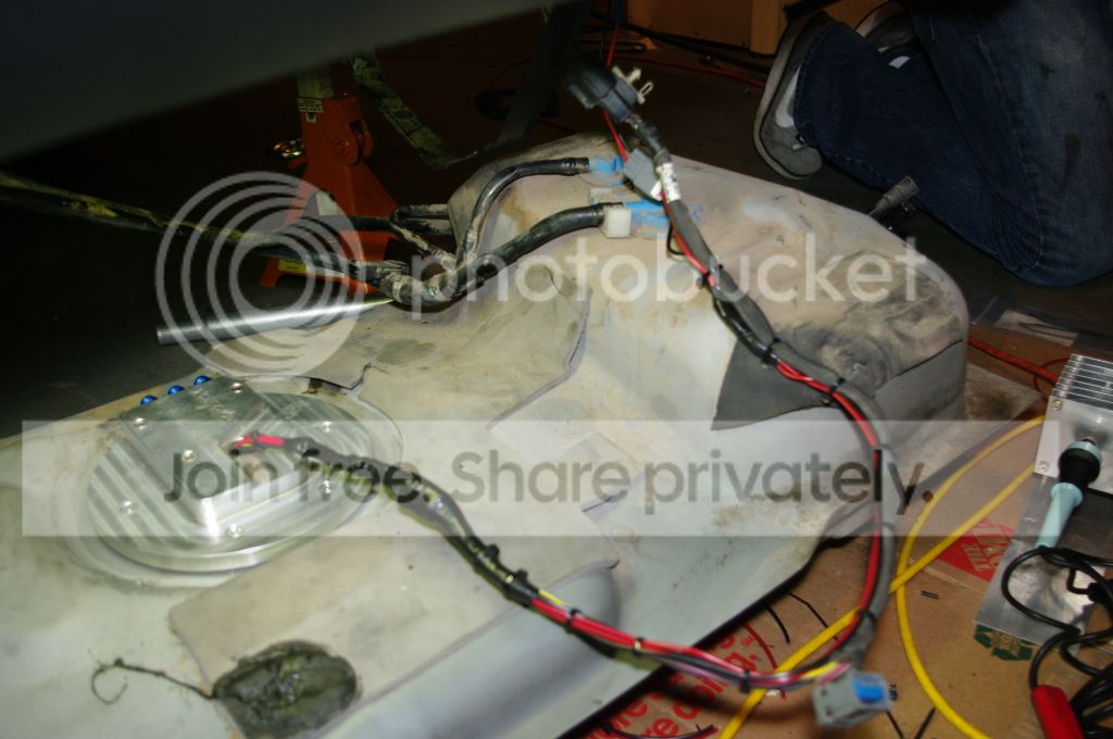

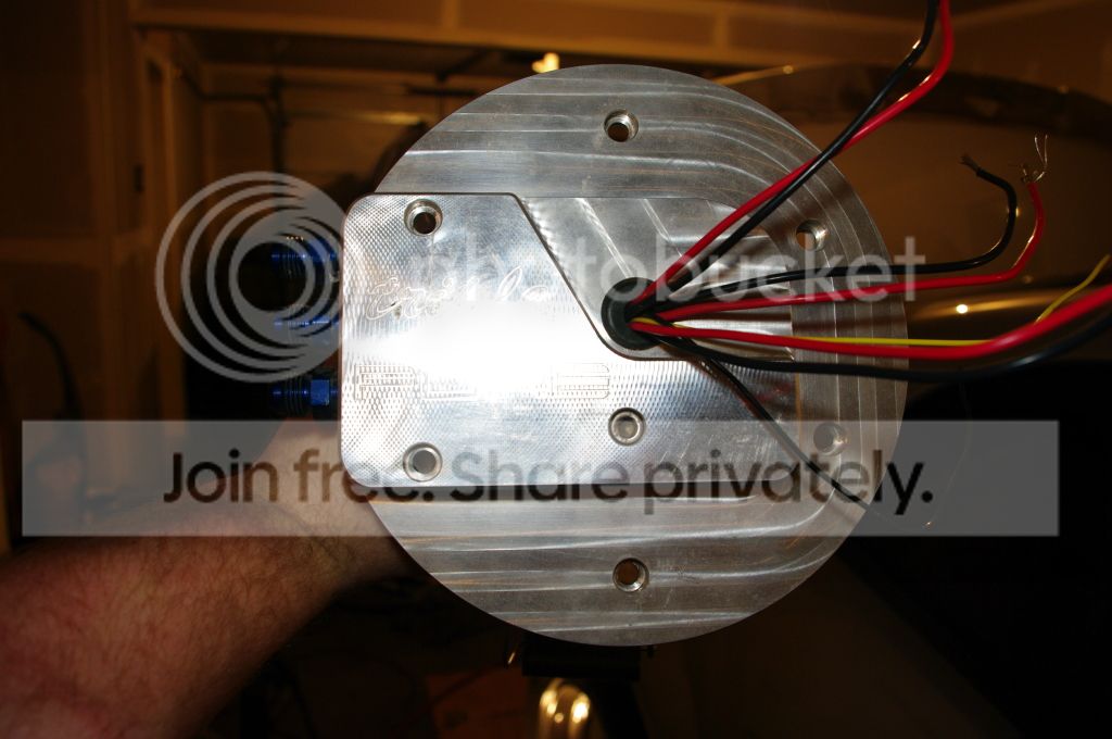

I dropped my fuel tank to install my FORE Triple pump fuel hat with 3 GT pumps that flow 340lph a piece. also installed -8 fuel line from tank to rails with 60lb injectors.

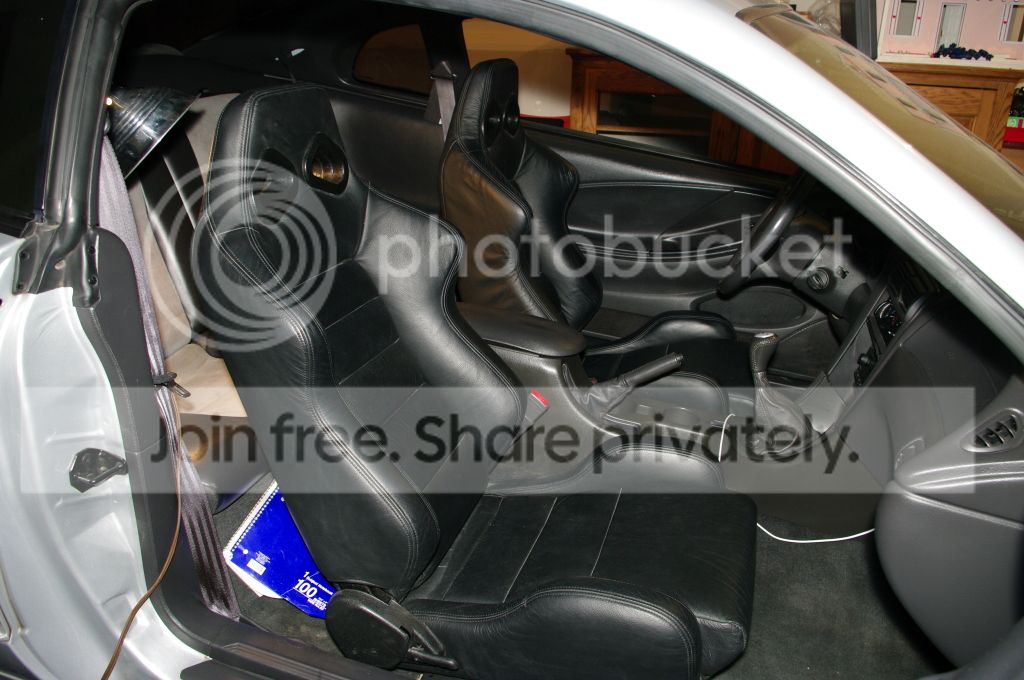

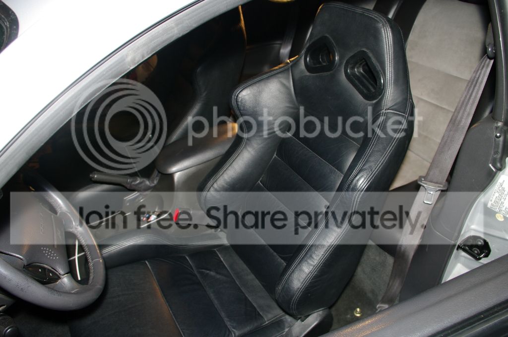

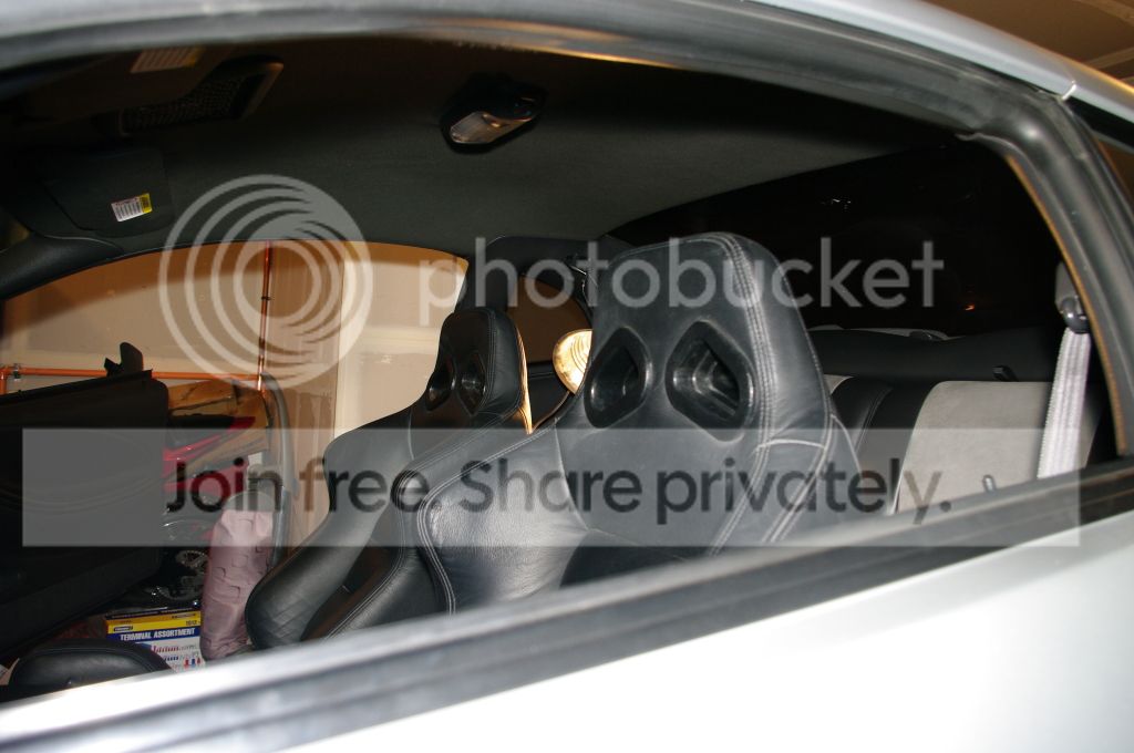

Decided it was a good time to install my new to me Corbeau TRS leather racing seats

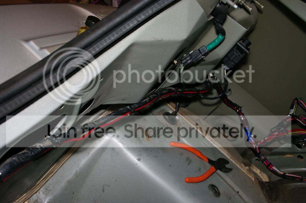

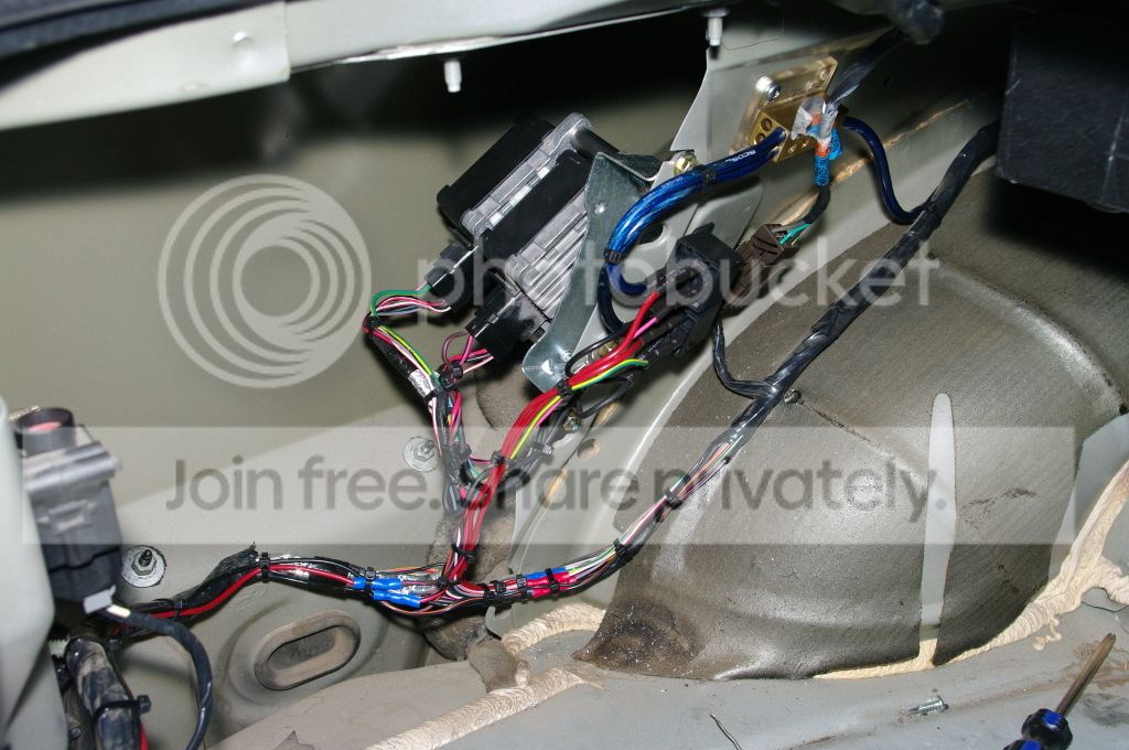

Also upgraded my wiring from one FPDM (fuel pump driver module) to dual FPDM's with 8 ga power wire routed straight from the battery to dual 40a relays to feed the voltage I am gonna need to send to the pumps. Also ran 3 new sets of 12ga wire to the tank from the FPDM's. There is no wire loom in the pic so you can see the install. It could have been prettier but oh well.

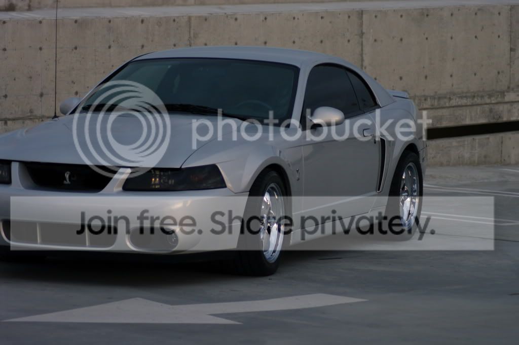

Painted new front and rear bumpers added new rear tail lights and chin spoiler. Also picked a new set of staggered 17" black chrome SVT wheels. Threw brand new 315/35/17 Nittoe NT05R's on the rear and Proxis on the front and rolled her out. Still hadnt changed out the drivers side tail in this pic.

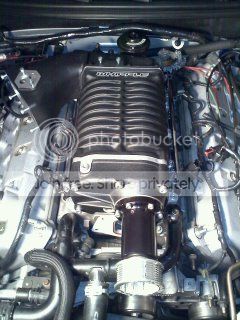

Oh yeah and here is a pic of last weeks whipple install.

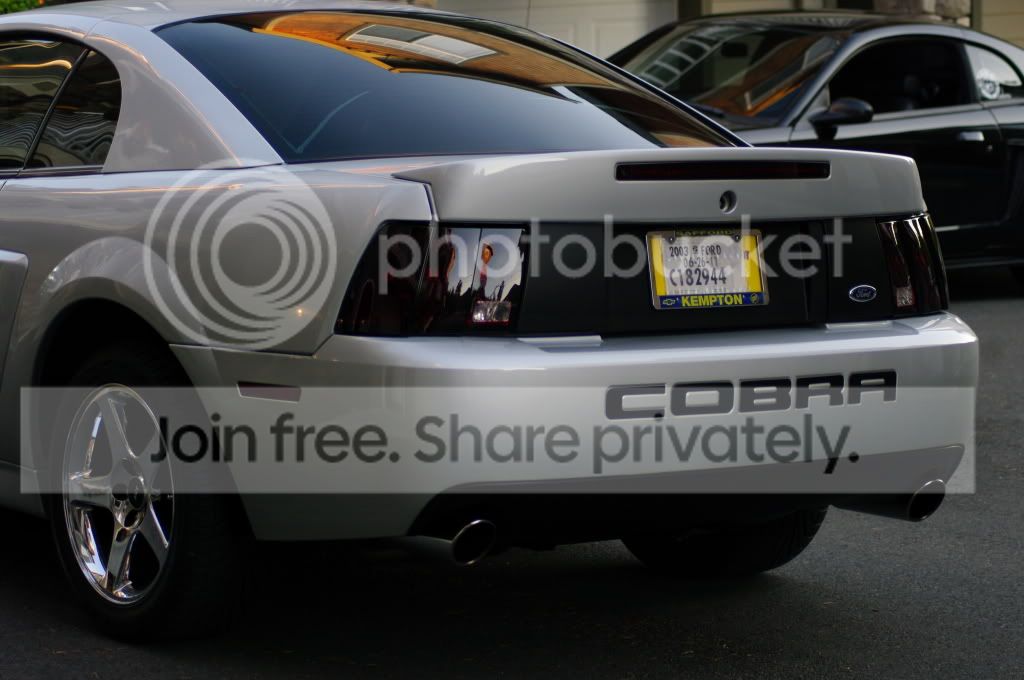

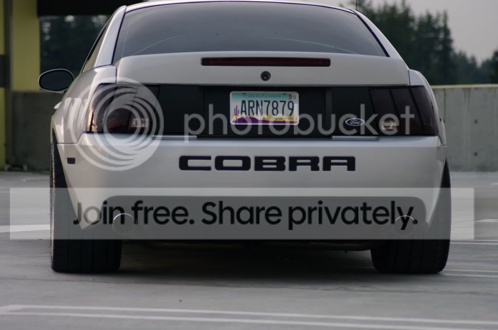

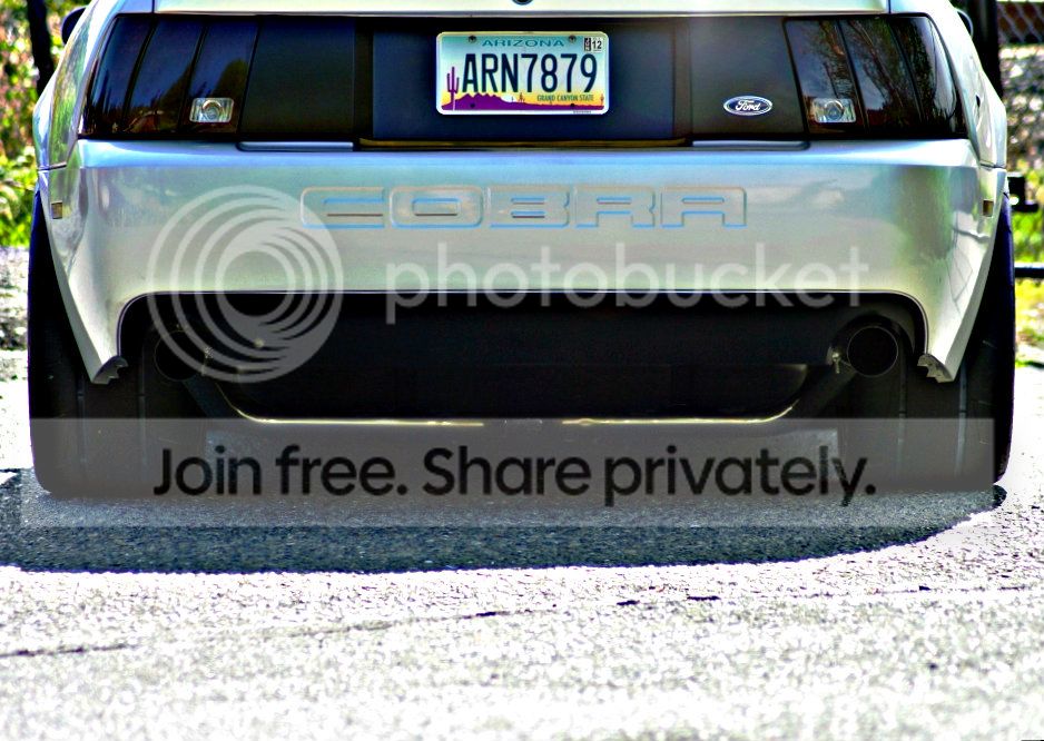

Installed some polished Magnaflow tails on my existing Borla Stingers. Got them as close as I could to being straight and what not. I also had my buddy tint my lights Since the AM ones werent even close to being smoked. Then decided to take some pics down by the water while the weather was good.
