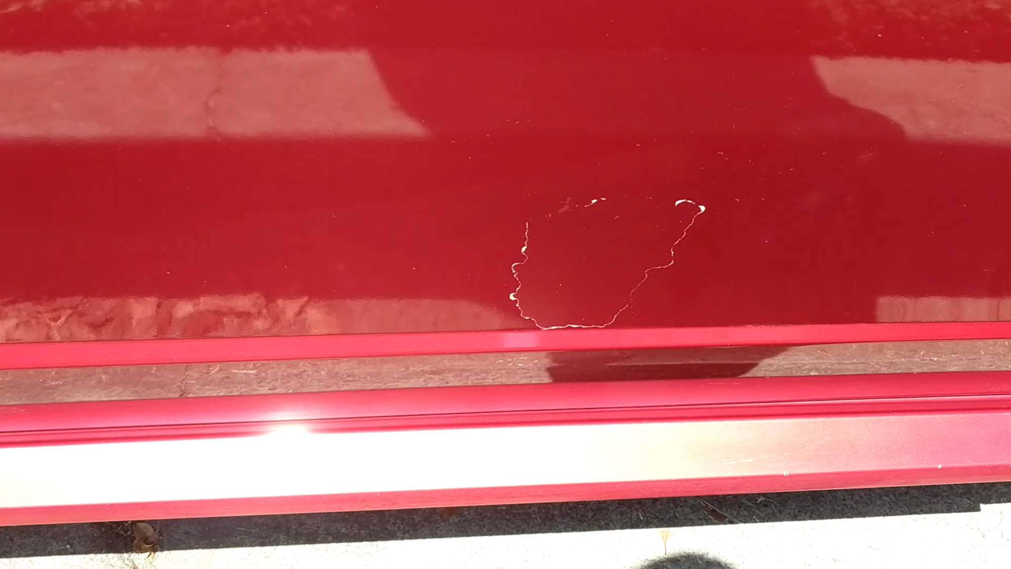

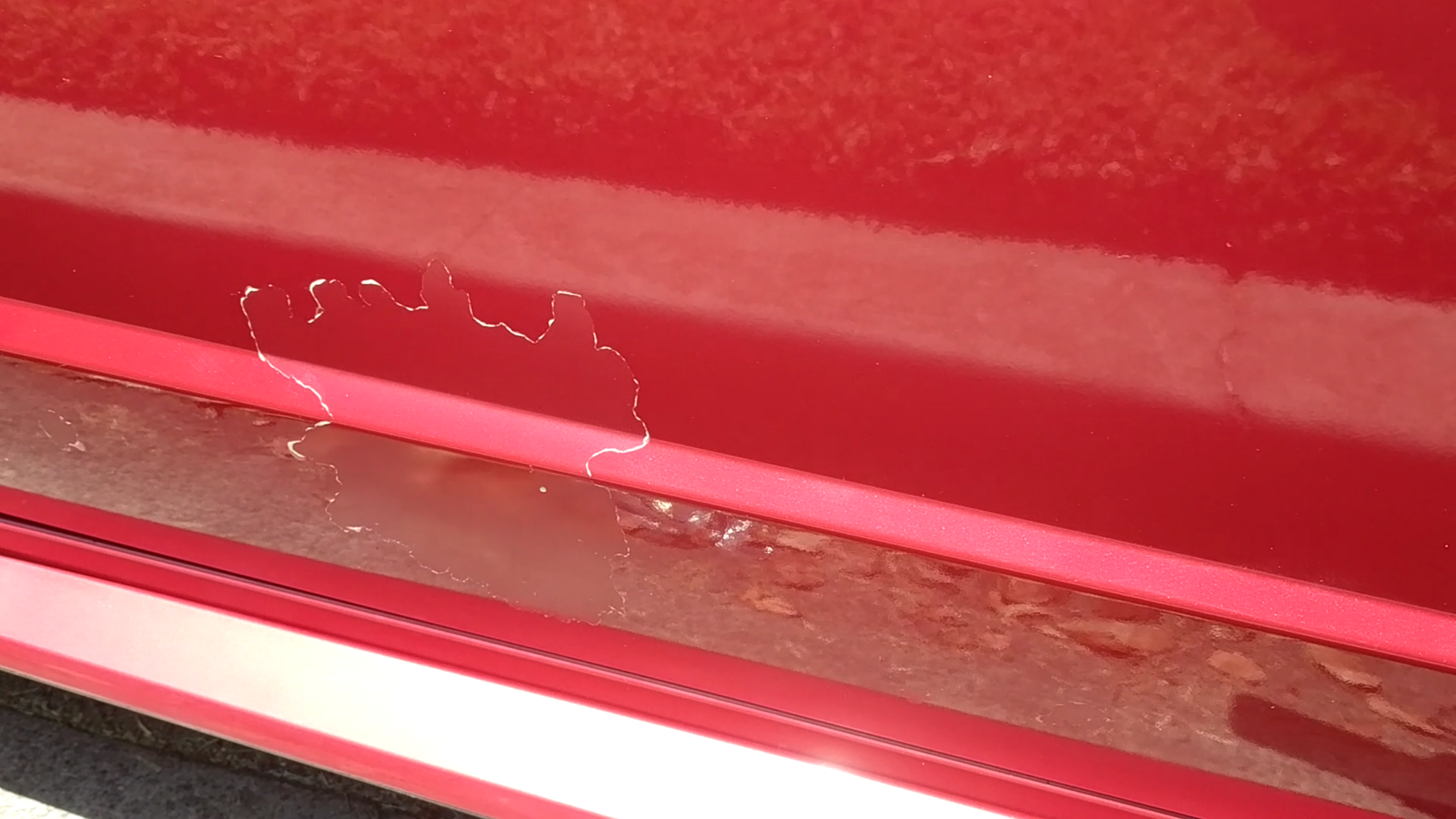

I just got my new mustang GT 2002, but it has these white circles on it. How do I get rid of them? When I touch them I can feel the layers.

Welcome. In the future put a more descriptive title on your posts - much more likely to get a response that way.
Those aren't "circles" - it is the clear coat coming off. That's why you can feel the edge. The only way to get rid of them is to repaint and refinish.

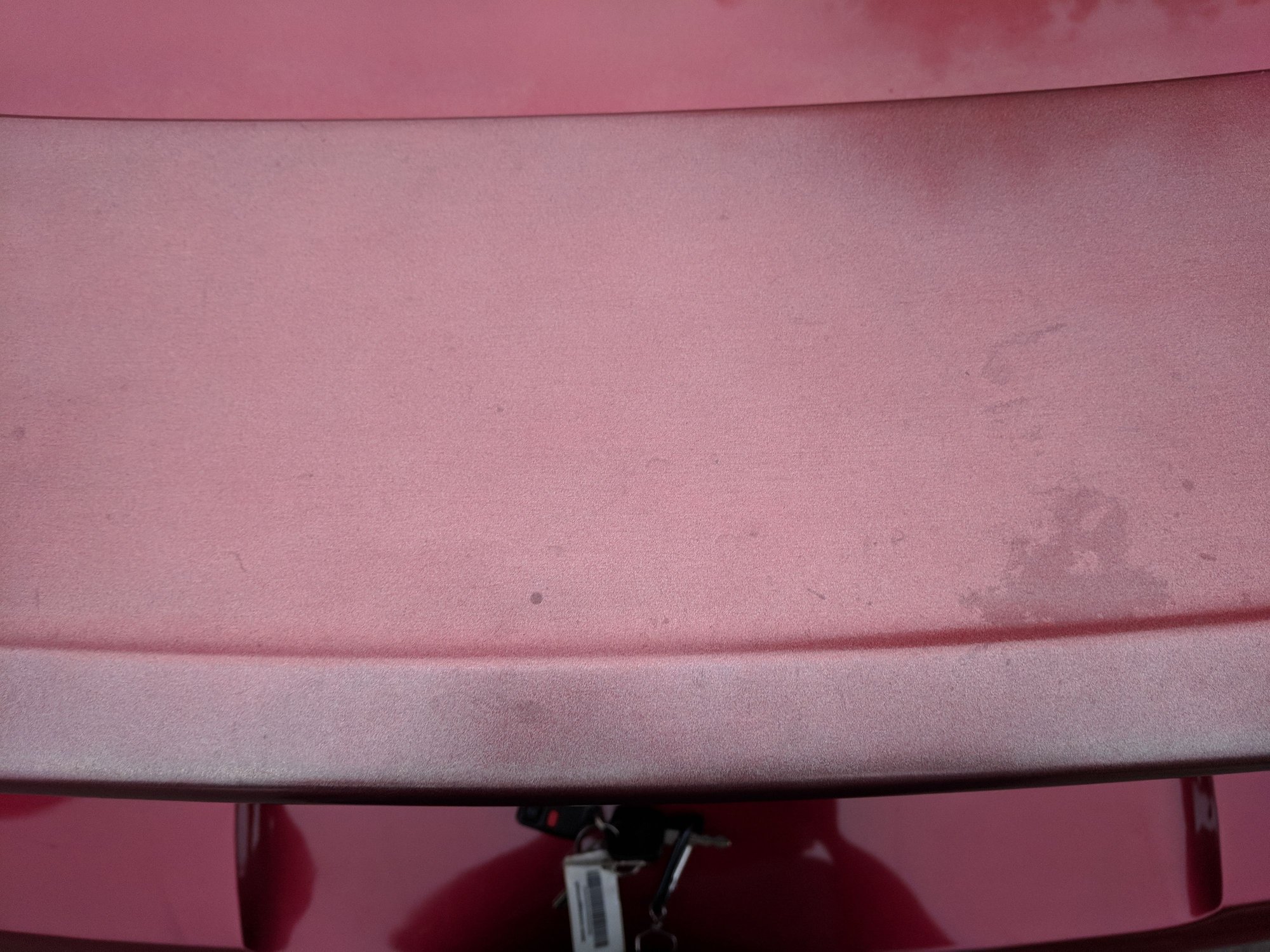

What should I do about this faded paint?

Just like your peeling clear coat -- repaint and refinish.

All u need to do is fether out clear with 1500 sand paper make shure you get all loose clear off then re clear useimg a blend methed then buff out it will be gone.
