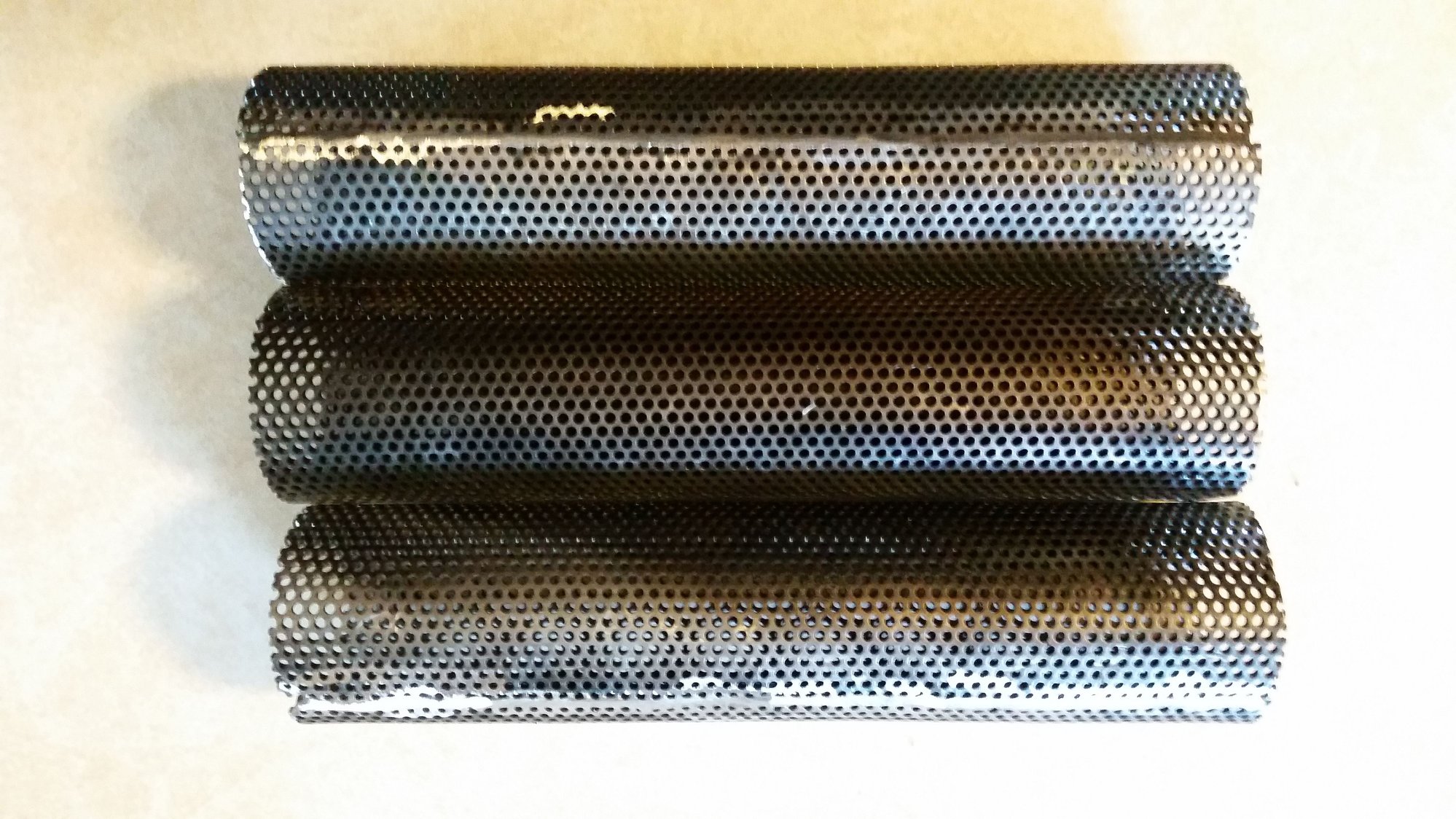

Starting on some baffles today! Obviously this isn't complete, but you get the picture...
I couldn't find a local supplier for the perforated steel, and I sure wasn't shelling out the ridiculous coin online companies want for actual baffles when I'm just making "test" mufflers more or less. Ending up getting enough of this steel for all my mufflers off eBay for about the same price as one actual baffle online.

Baffles are done. If you remember back to the two designs I plan on making, one set of mufflers will use about one of these baffles per each muffler. The other set will only require about half, so one will be cut in half and used for two mufflers.

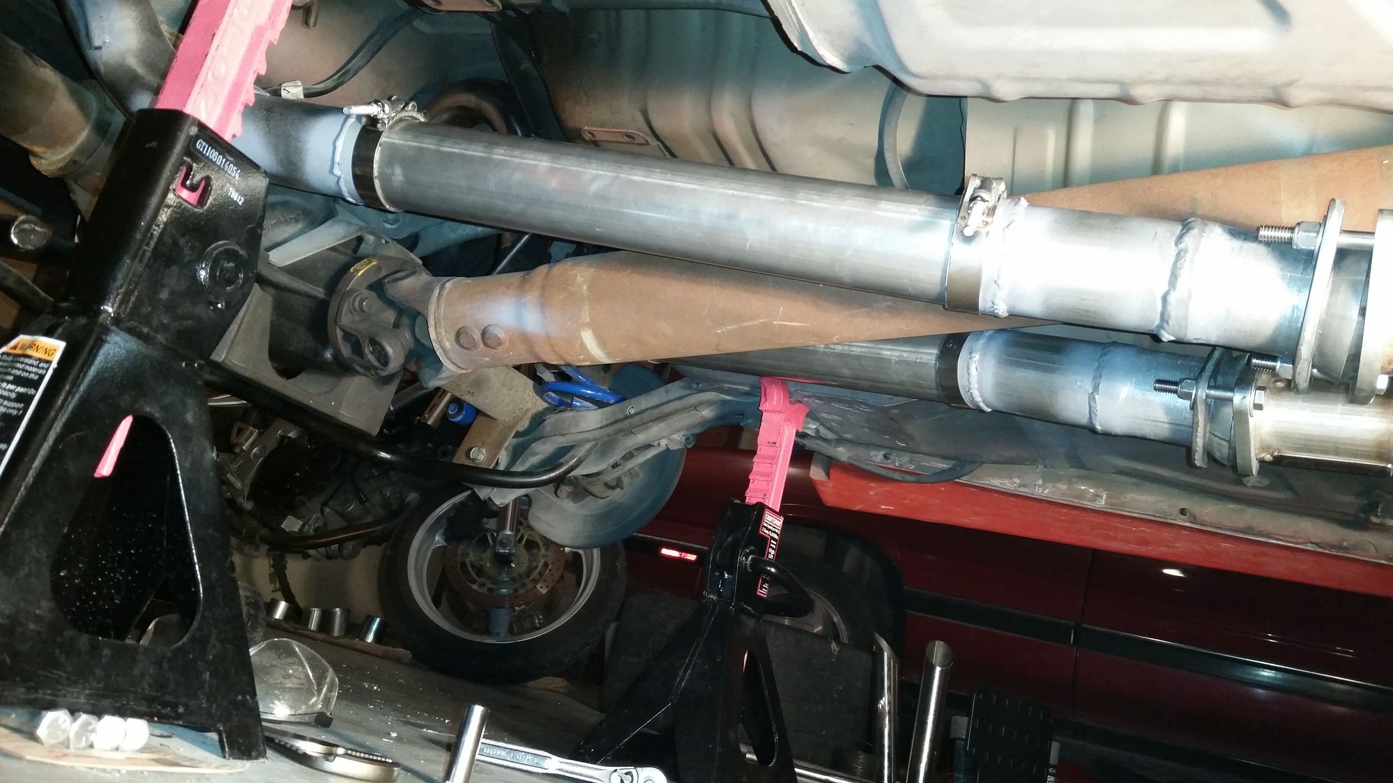

Took the Flowmaster catback out this morning and am working on fitting the new tailpipes. Just holding them up in place it looks like the bends are right for a new edge. I don't know if you can see in the picture though: I need to add an additional hanger right behind the muffler and change the hanger at the tips on both sides. Just as I had thought from what I had read previously.
After I get the tailpipes hung with the new tips, then I will work on making the flow tubes. I've got two 90* bends that I plan on cutting into whatever angles I need to weld to the end of the flow tubes and to the beginning of the new tailpipes to make them in line with each other so as to be able to swap any straight through muffler.

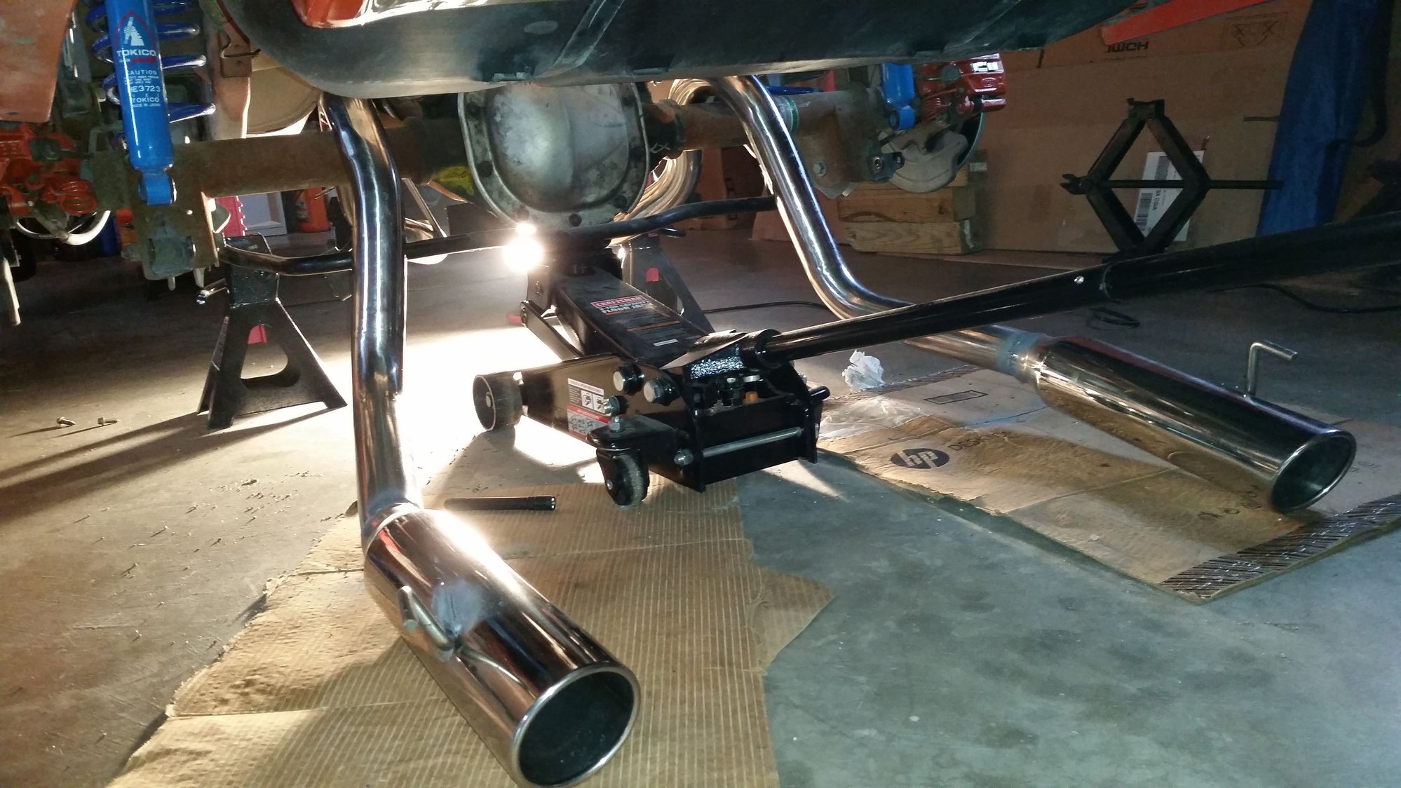

Everything tailpipe wise is welded and ready to go back up. Next step: flow tubes.
Also let me take a moment to speak to the quality of the SR Performance tailpipes from AmericanMuscle. These things are great. I mean it wasn't too bad installing them on a car they aren't even technically meant for. The bends are spot on. They fit very nice and I now have more clearance in places with them than I did with the Flowmaster catback. Plus they are 304 stainless steel (I checked with a magnet too, no attraction). I have zero complaints about the quality especially for the price!!!
The tips are Flo-Pro stainless tips I bought of eBay. Also 304 stainless (also tested with magnet -- good to go).

Finished the exhaust (aside from the mufflers). Started it up and leak free!
You can see the straight section of pipe I have in temporarily until I make mufflers next week.
