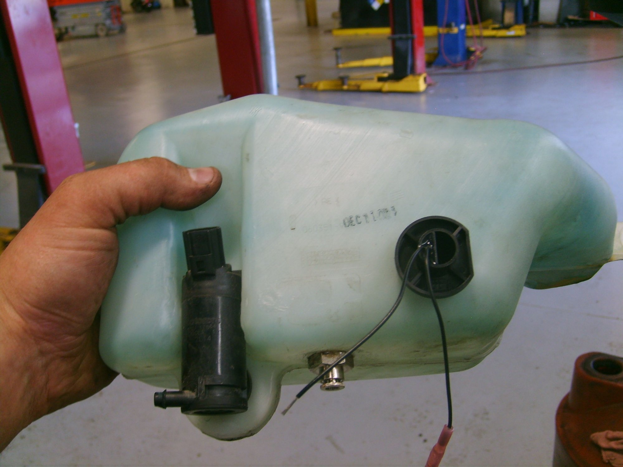

i installed the Snow Performance Stage 2 MAF boost cooler, this model uses the MAF signal voltage to ramp up the meth injection
from 10% to 100% and allows you to set the start point and full injection point.
i started by mounting the nozzle in the air intake just before the TB per the instructions, and since
i have plastic intake tubing i chose to buy the optional threaded fitting so that the nozzle had more than 2 threads to secure it into the inlet
since the engine bay of my car is a bit cramped, i chose to tap into my stock washer resevoir instead of using the supplied 3qt. resevor from the kit.
i started by removing the lf tire and wheel liner, then the resevoir. i then drilled a 13/16" hole in the reservoir per instructions to mount the level sensor, then i drilled a 5/8" hole and mounted the supply fitting using some E6000 adhesive. i coated the threads and screwed in the fitting directly in the reservoir, the fitting cut threads
in the plastic and the adhesive made a good seal.
i then mounted the pump on the back of the front bumper near and bleow the resevoir so that the fluid will gravity feet the pump and always keep it primed.
time to reinstall the washer res. and wire up the sensor and pump
while i was wiring up the pump, i decided to add in a take out with a 1 wire connector on the power side of the pump so i could jump power to the pump whenever i wanted without removing the lf tire or wheel liner. i figure it could come in handy for testing should anything fail.
next i mounted the MAFU controller to the lid of the underhood fuse box using a few small machine screws, this keeps everything nice and tidy.
next i routed all the rest of the wires, tapped into the MAF signal wire, routed the 2 wires through the firewall for the LED indicators, routed the meth line to the nozzle, and reinstalled the wheel and liner.
i removed my gauge pod for my boost gauge and drilled 2 1\4" holes and mounted the 2 LED's, 1 is green and lights when the system is injecting, the other is red and lights when the level sensor in the reservoir shows low
complete!
all that was left was test and tune, i started with the middle of the 3 nozzles that come in the kit, after a bit of flogging i found that it was too large for my setup and would cause the engine to break up before i got out of 1st gear. i swapped down to the smallest nozzle and retested = success! no break up, no detonation, and by looking at my boost gauge i picked up 1psi of boost. total install time 4.5 hrs using a hoist, will prob take more on the ground.
i am currently running my own boost juice, that i make by purchasing a 5 gallon pail of methanol from a local supplier for $34.00 and then i mix it 50/50 with distilled water. total cost for 10 gallons of water/meth $34.00 or $3.40 per gallon, snows pre mixed is around $8.50 per gallon.
