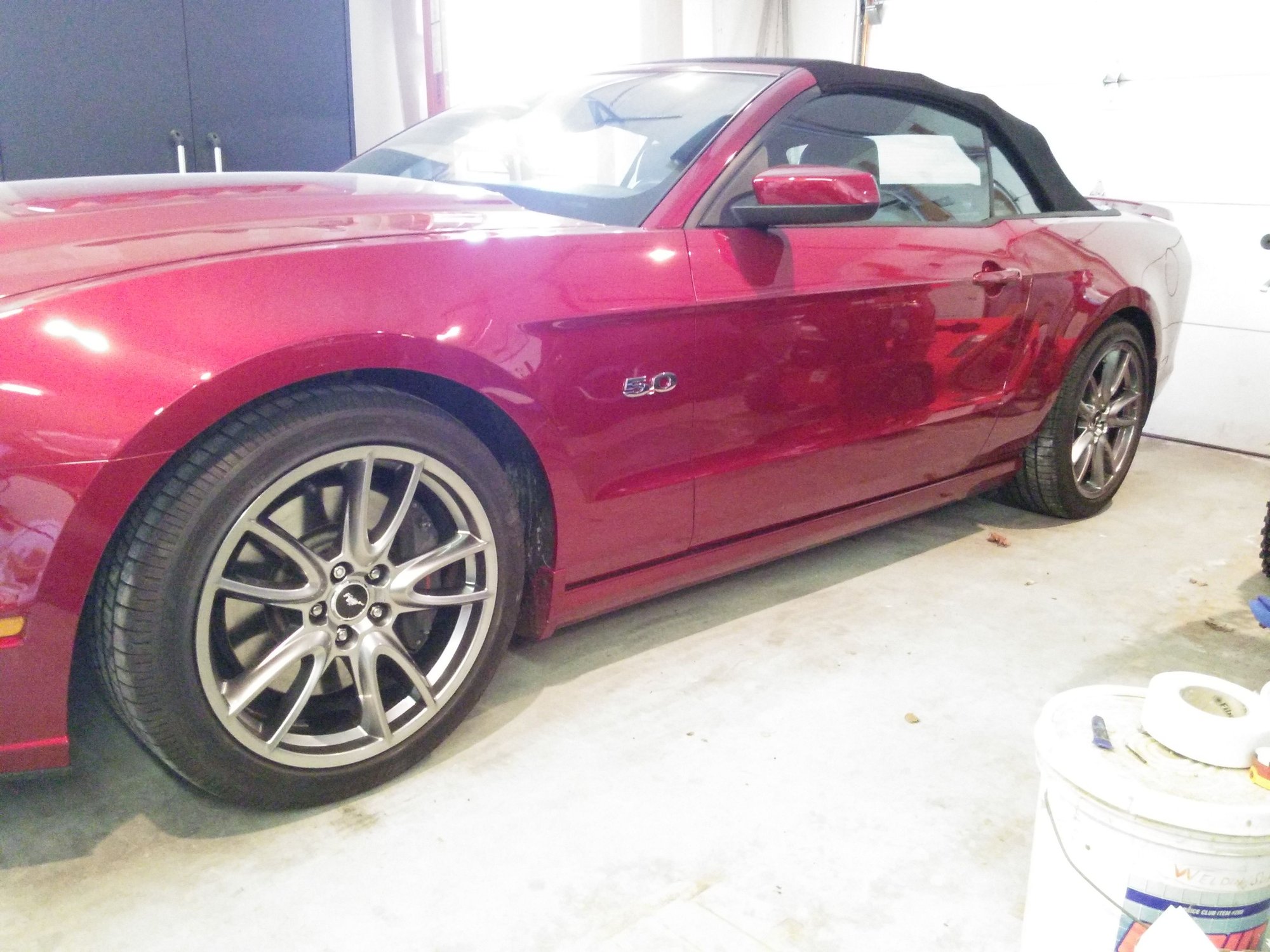

Bad garage pic but definitely lower. I would expect a bit more when it settles out.

Did you measure before/after spring swap? My rear fender well to ground was 30" before, 28.75" after & 28.5" 10 days after.
