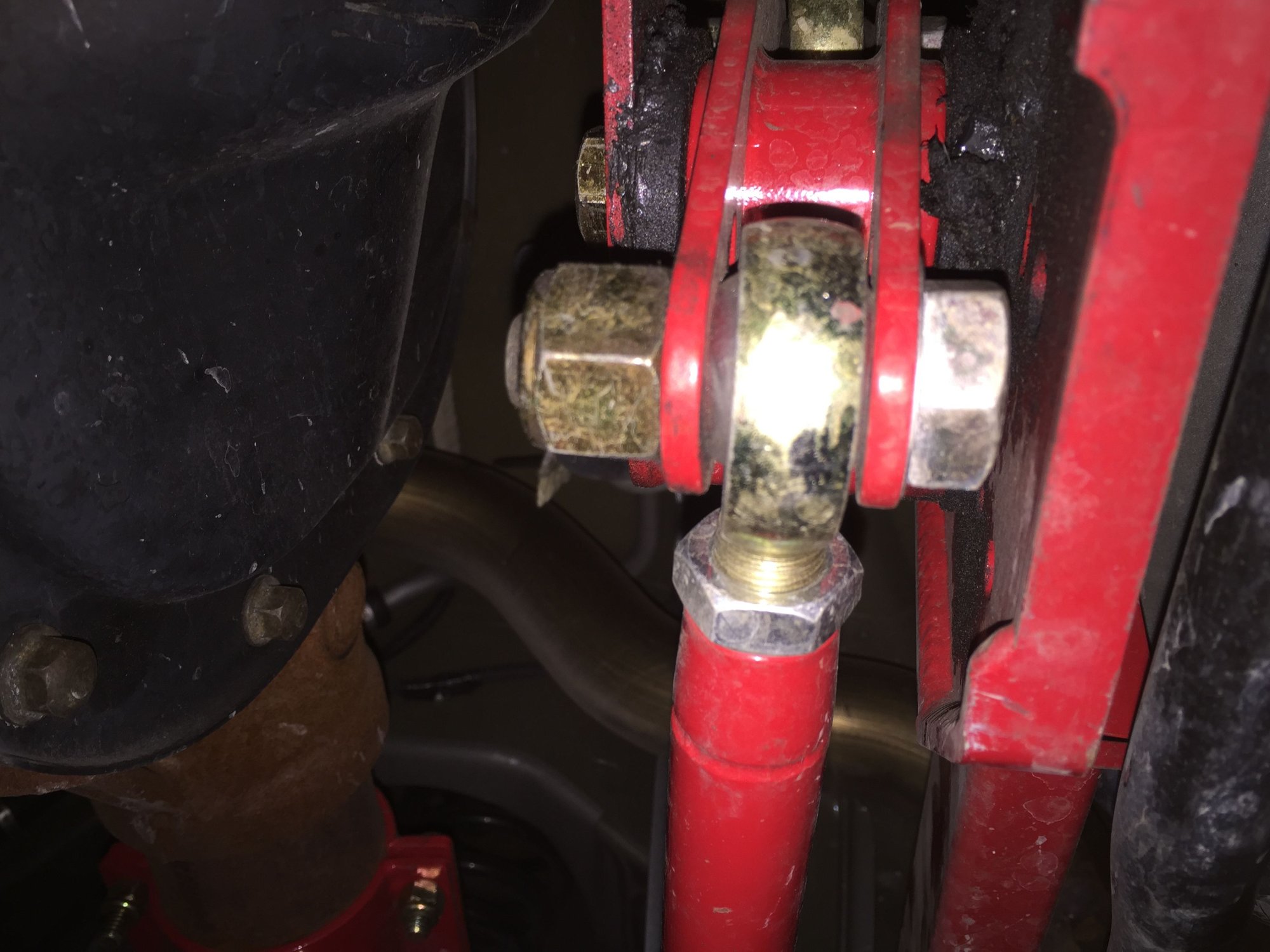

So I went to take mine off and see if it helps. Before I did I tried inspecting it a little closer. There is actually no evidence of it making any contact with the BMR cross member. So I started tying to tap it and push/ pull on things to see if I could feel or hear and play. Well I discovered the poly rodend link on the drivers side had some sort of clunk and play in it. I made a video of it. I know the rod end is torqued and the poly end is as well. It almost feels like the play is where the rod end threads into the main rod. Jam not is tight, but that's the nut that was loose last time I checked. It is still tight from when I tightened it.
how do I fix this? Replace poly/rod link?

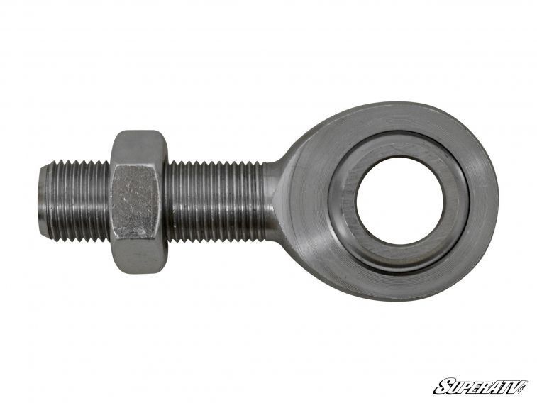

What kind of a ball am I looking at there (inside the end piece that you secure with the jam nut)? Is it all metal or is it something like polyurethane with a metal sleeve running through it? If it's the latter, is the metal sleeve longer or shorter than the ball? I only have your pictures to work with, as the pictures on BMR's site aren't describing or showing this in close enough detail.
Do you know offhand how many rod end/link threads are engaged (or the actual length of thread engagement)?

All metal hiemjoint.
Plenty
of thread within the red pard of the rod.
heres my speculation at the moment.
im thinking that because the jam nut was loose and had backed off, the threaded portion on the him joint had some play within the main link. This play allowed unnecessary movements within the link threads and this movement caused wear within the threads. This wear has now increased the tolerance between the threads on the grim joint and the threads within the rod link. This increased tolerance allows the heim joint to shift within the rod link causing the clunk.
i made a video of it making the noise, but don't know how to post it.

By the way, you mentioned the drivers side rod end but your pictures show the passenger side.
