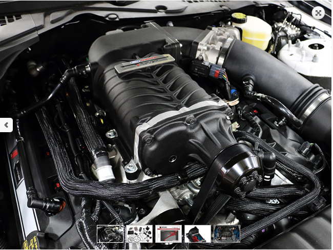

Thanks Mr D. I have looked at the R2300 Phase 1 and saw good reviews and is within my price range. The consensus is its more difficult to install than a ProCharger. I like that it assists with the resale value. Did you do any dyno pulls after install? Assuming you installed the kit, did you do any other upgrades based on the supercharger? I currently have Eiback Sportline lowering springs and went with 20" staggered rims. I also have a DiabloSport, 91 octane tune on it which really woke up the car. I notice more wheel spin than the stock setup though. I wound up with 442 @ crank/379 @ wheels on a the dyno which was a slight improvement. But not nearly enough for what I would like.
I went with the Roush TVS also. After the install, I got hooked up with Justin at VMP for a pulley swap and tune. Night and day difference. Next time I will just start with VMP.
Install wasn't too bad, depending on your skill level. Took me about ten hours. Patience is the big thing.
Thanks, I really like it. Pulley swap was pretty simple, since I'm at about 4500 ft above sea level, I make less boost. I'm sure the guys at Roush probably knew thiss, but they are pretty conservative. So I got ahold of Jason at VMP, and he helped me pick out a smaller pulley. The small pulley spins faster, making more boost. Was a simple install, a few bolts and a belt. Then VMP had me do some data logging and tuned my car via the Internet. Jason assured me that I am right at the ragged edge for stock internals. So I've never been on a dyno, but go still, I can imagine the car running any better.
@CPTCO, what was your initial pulley size and what did you go with after speaking to VMP? I spoke to Justin and may go with a VMP Gen II Stage I from their website since I can pick the pulley I want at no charge, price is good, and the equipment got some good reviews. VMP did take some hits for poor customer service and their websites sucks ***. Its been up and down all day today and I got pretty frustrated. But Justin is very knowledgeable and has been mentioned on other performance sites and forums. A guys I spoke to at American Muscle even mentioned him. He provided some consulting on what I would need to upgrade for the smaller pulleys (i.e. fuel injectors, fuel pump boost, fanned heat exchanger etc. all the way up to clutch, crank shaft, etc. for the smallest ones). Stage I comes with and 85mm pulley but Justin was okay with me going with the 82mm (10lb boost) or 79mm (11-12lb boost) as long as i at least upgrade to the 56lb/hr injectors. I may consider the dual fan heat exchanger but I didn't get the impression the he thought it was necessary. I think the 79mm would put me at the ragged edge also. That would be about as far as I would take it except for possibly adding lt headers. I've checked out some youtube videos on VMP dyno pulls and found one that was using a GEN II with an 82mm pulley that was able to get 618 to the wheels. Don't know if there were more mods or not and you can only believe so much on the Internet.
But I like that I can pick and choose the options I want through VMP.
