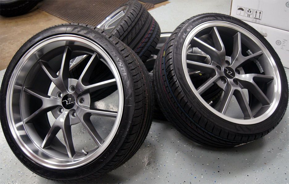

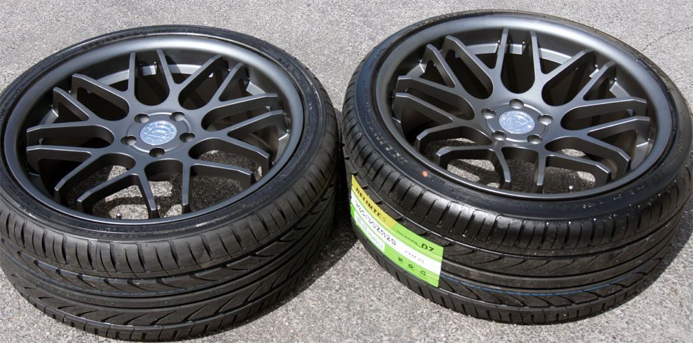

I'm currently running 18" staggered FR500 Anthracite wheels and thinking about going towards the 20". I don't know what's best at the moment and lately my front driver side has rubbing the back-inside of the fender well. I checked a few tire shops within the area. Nothing is wrong with the suspension just a few high tides (warps) or something on the tires. I've been looking for a new set a tires but I started thinking about 20" wheels. I'm told I need spacer in the rear for the 20" wheels and I'm not sure about tire sizes either far as what's best for it. I got 265/35/18 in the front and 285/30/18 in the rear. If I'm changing the tires and keep the 18" wheels I'm going for 245/40/18 in the front and 285/35/18 in the rear. If I get 20" wheels this is what I'm going for:
1: http://www.ebay.com/itm/191458110465?_trksid=p2060778.m1438.l2649&ssPageName=STRK%3AMEBIDX%3AIT
2: http://www.ebay.com/itm/191456902382?_trksid=p2060778.m1438.l2649&ssPageName=STRK%3AMEBIDX%3AIT
I have the 18" version of these wheels right now...
My car is vibrating because of the tires and one of them rear has a plug in til I figure out what to do otherwise. I caught a flat on Thanksgiving Day... I'm already at 103972 on the odometer it probably has less than that but oh well. There's nothing wrong with the wheels I now other than curb rashes. I keep losing pressure out of the tires and the combination of the car vibration that is worrying me like something is about to give out.

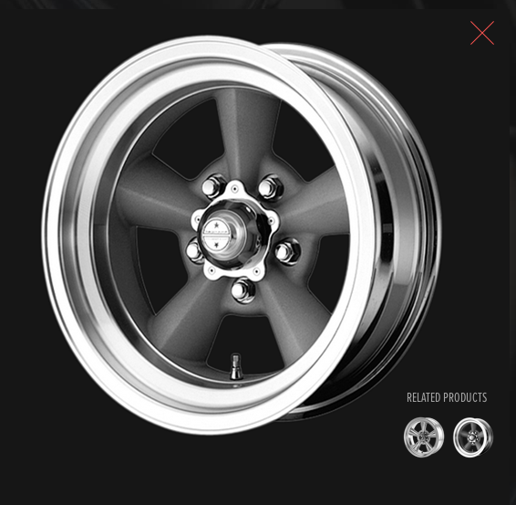

Ah, shock the teeny boppers & go "Old School" with a set of 17" like these & forget the "wagon wheels"! Then the wheels won't look like the cheapy chromed candy dishes you see today! LOL! Fat chance, huh?
Old Dec 29, 2014 | 04:49 AM
PNYXPRESS's Avatar
PNYXPRESS
Joined: Mar 2008
Posts: 2,952
From: Clermont, FL
Then he would be like almost every other new edge owner with cragar styled bullets.
Do a little research before you post, Mr D, that style and size was stock on this gen GT.
