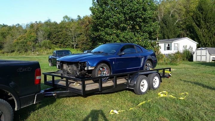

So I bought a 2000 V6 that needs a little work (it's a project). Here's a picture.
When I bought it, it had no brakes (by that I mean I put the pedal to the floor and I kept rolling) so I assumed that was the master cylinder. After beginning to take things out from under the hood I realized I'm missing a few things including the ABS Control Module. Could that be the reason that there are no brakes? Also, where could I find one relatively cheap? Would I be better off pulling one from a junkyard? Thanks in advance for the info.

The master cylinder is filled to the top with fluid and it's been sitting in the garage so leaks would be easy to notice but I haven't seen any fluid on the floor. I assumed I was supposed to have abs because my brother has the same exact model but a different color and he has abs. There's also multiple parts on the front end that were missing when I bought it so I thought that might have been taken off after being damaged in the accident.
