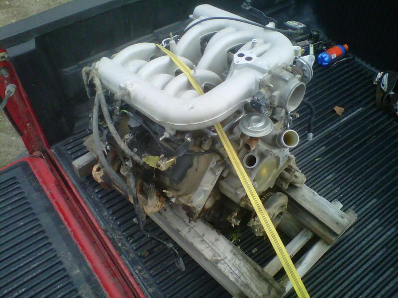

One day I was in the impound lot of my mechanic's and I look across the alley and see an engine sitting there(at the back door of a parts store). I looked at it and thought it was a windstar 3.8. Well I wait a few months to see if anything happens to it, nope still sitting there. So I walk into the store and ask someone about the motor out back. They said its junk so its going to the salvage yard. I then told him that Ill take it, so we got a forklift and put it in the box of my truck.
After a couple days I look at the engine. Start getting some numbers and I find out its a 4.2L from a 97 F 150. SCORE!! So now Im tearing it down for a nice build... shooting for 500+ on meth inj.

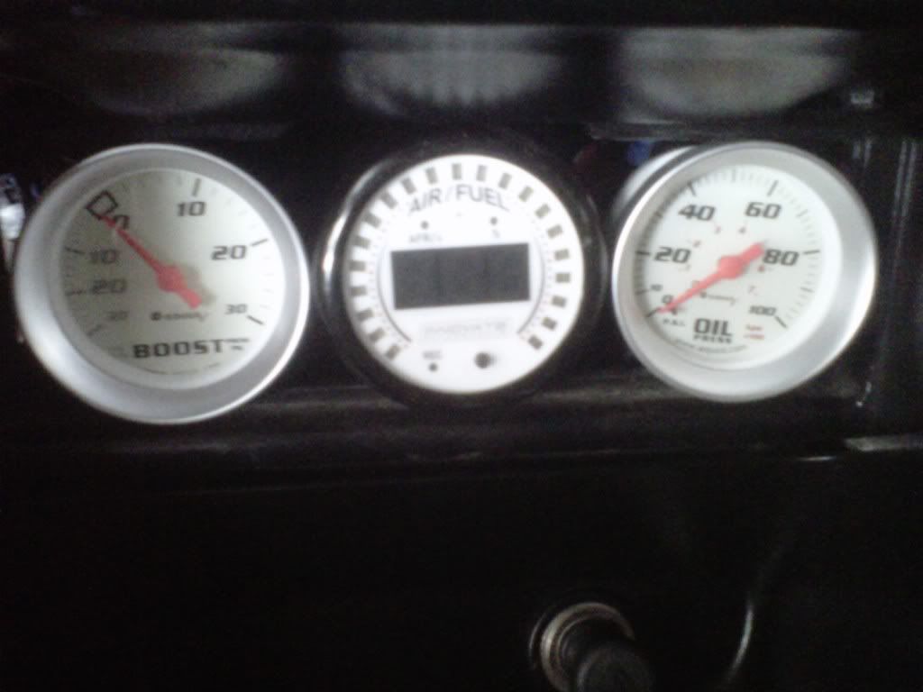

I bought some gauges and decided where I wanted to mount them. Boost 30/30 Mechanical, Innovate LC-1 wideband w/ XD-16??? gauge, Oil pressure 0-100psi mechanical
Seems like a good location, out of the way, kinda sleeper, good visibility.
