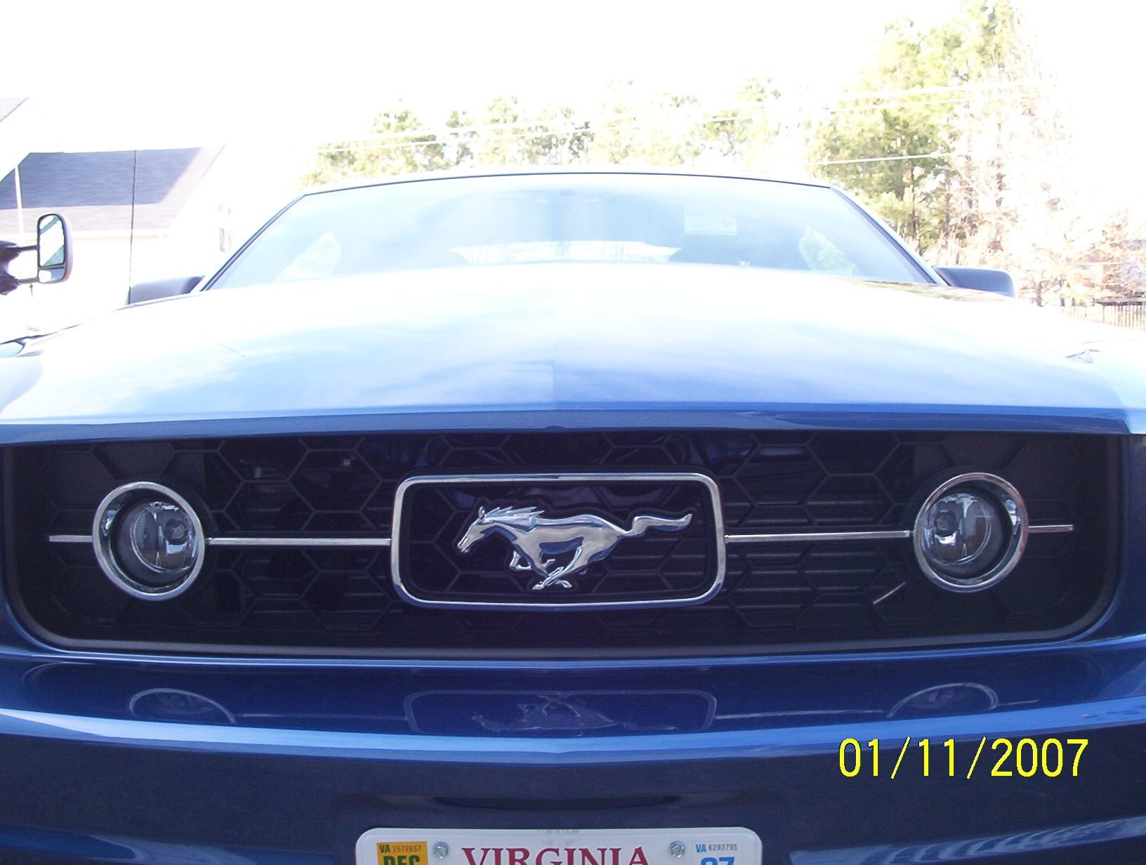

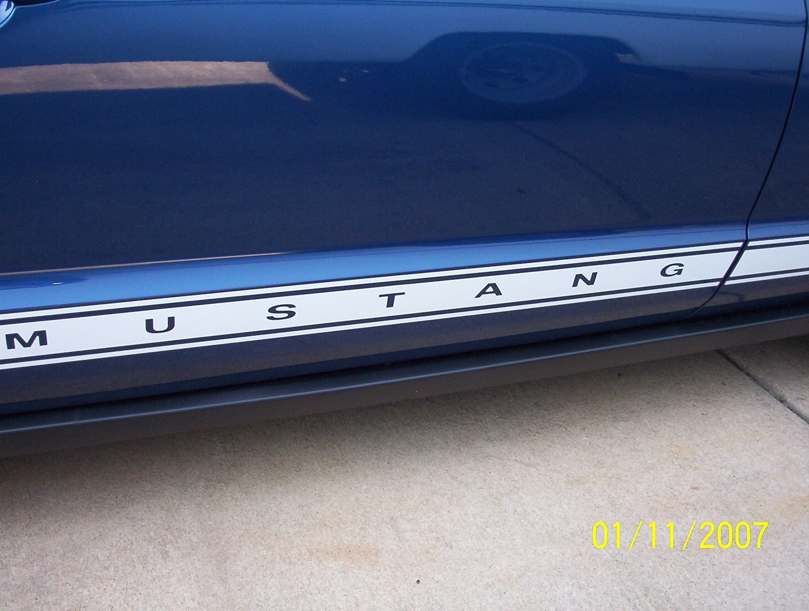

Wow, only 52k miles and bought it back for $1800! I would most definitely try to fix it! Look at my '07...it is a Pony Package. They came with 17" rims as well as a Mustang side stripe. Also they came with the smaller fog lights on the front grill. If you do not see these, then it could just be a premium Mustang.
Good Luck and post pictures.
