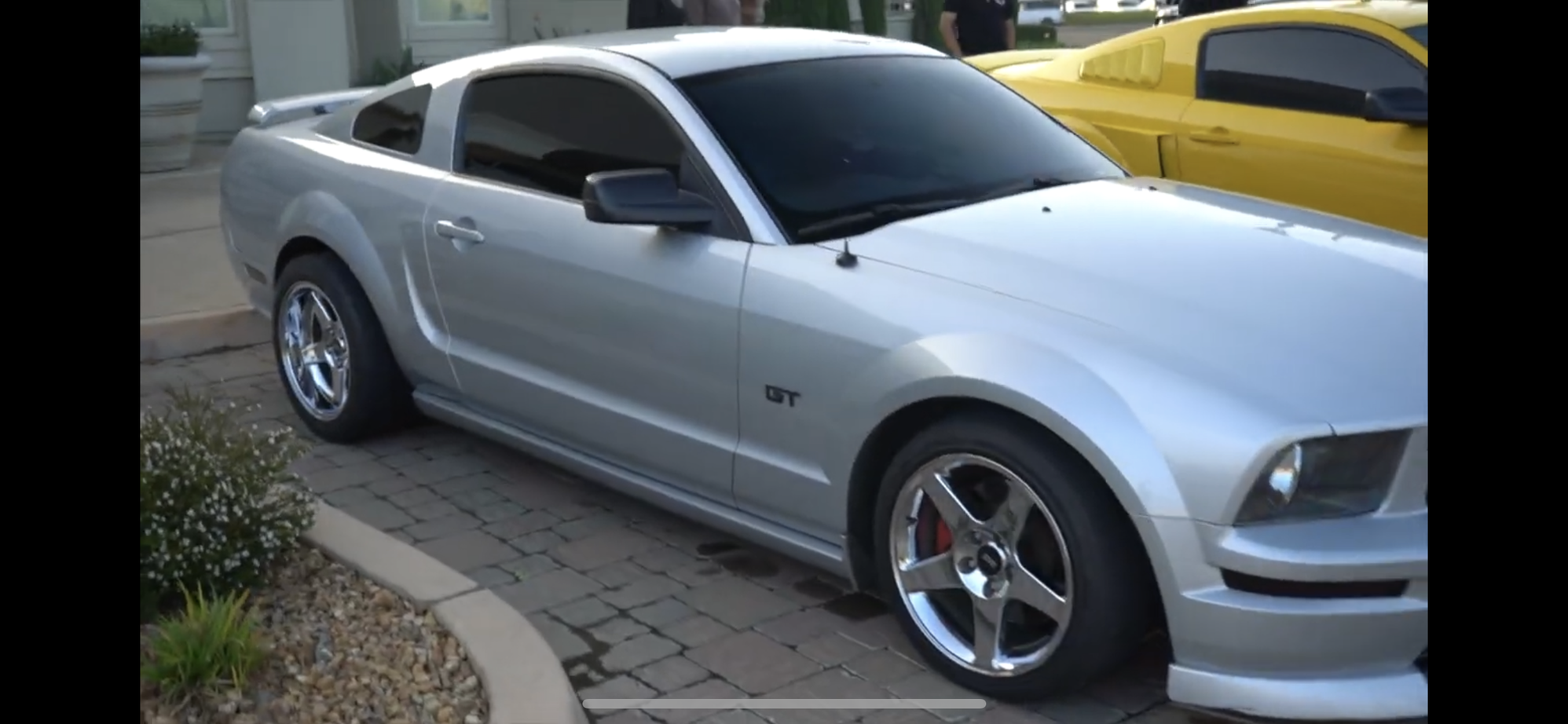

I found the wheels I would like to go with they are deep dish cobra reps in the rear and non deep dish in the front.The fronts are 18x9 and the rears only come in 17x9 and 17x10.5, I was wondering if you guys had any tire setup recommendations to keep rears meaty I want I to look similar to this.
All help greatly appreciated

I would go with a different wheel set up. If staggered, the rears should be larger than the front. Having said that in order to keep roughly the same profile height you would need to go with one or two size larger in the rear to offset the front. If the front is a 45 profile, then the rear would have to be a 55 or 65 and you probably wouldn't be able to keep the same tire design which would make matters even worse.

Yeah I would not do that set up. Think I seen you over on FB in the 2005-2009 Mustang group.
