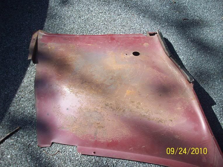

OK Figured it out....
3 - Is this a kick panel?
4 - Same as 3 (other side)
5 - Any idea which wire harness this is, #6 is a specific connection on it
6
7 - This looks like an power window unit. Am I right?
8
9 - Is this a drum brake?
10
11
12
I don't know any of these parts, if anyone can help me, I would appreciate it.
3 - QUARTER TRIM PANEL (go on each side of the rear seat)
6
7 - WINDSHIELD WIPER TRANSMISSION
8
9 - Is this a drum brake? YES BRAKE DRUM
10 SPEEDOMETER CABLE AND SPEEDO GEAR
11
12
BRAKE MASTER CYLINDER AND POWER BRAKE BOOSTER.

#1 is a headlight wiring connector, #2 is a left-rear splash shield for the LH front wheel. And a really crappy job of installing the seal, too. They are supposed to be stapled, not screwed, and attached better than that. IMHO buying them separately is a waste, I always use the ones that come with the rubber seals already attached.
Notice the bits of glue on #3 & #4. There is supposed to be a thick layer of jute glued on there, this is available new, die-cut, and reduces noise inside the car. If you are an adult, you'll want to put this back on when you refinish the panels.
#5 is probably an instrument connector, but I'd need to see the end, in focus, not the side.
