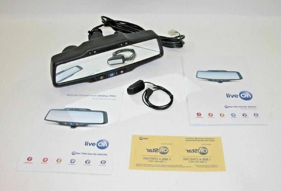

OnStar FMV:

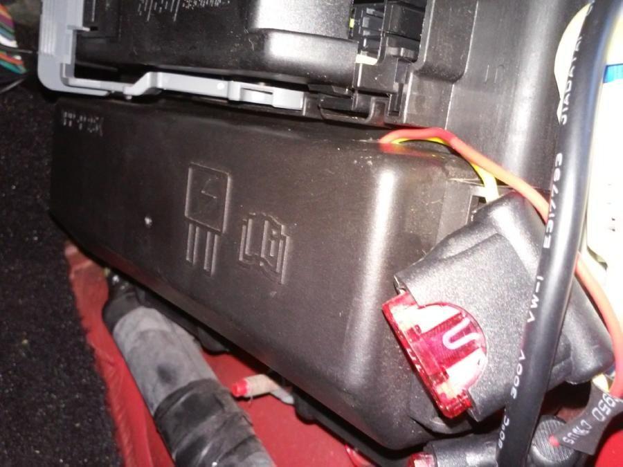

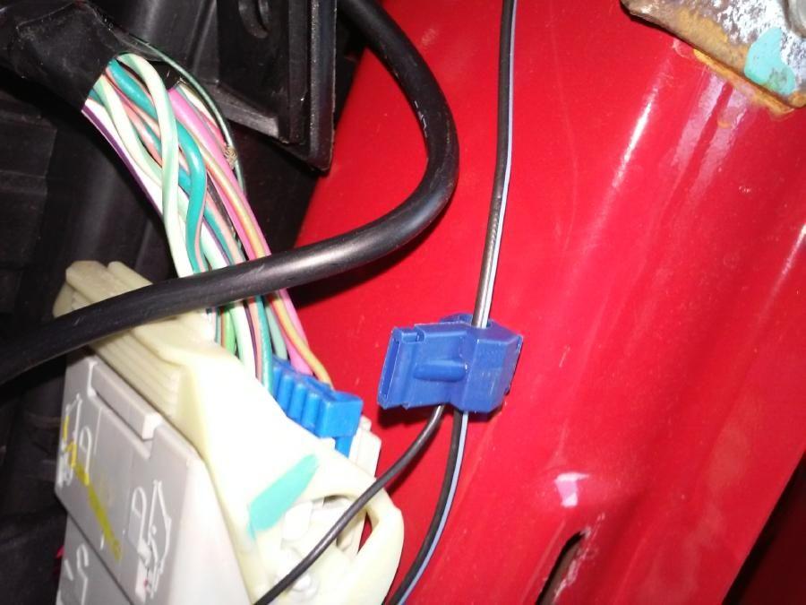

Wiring:
Ground:

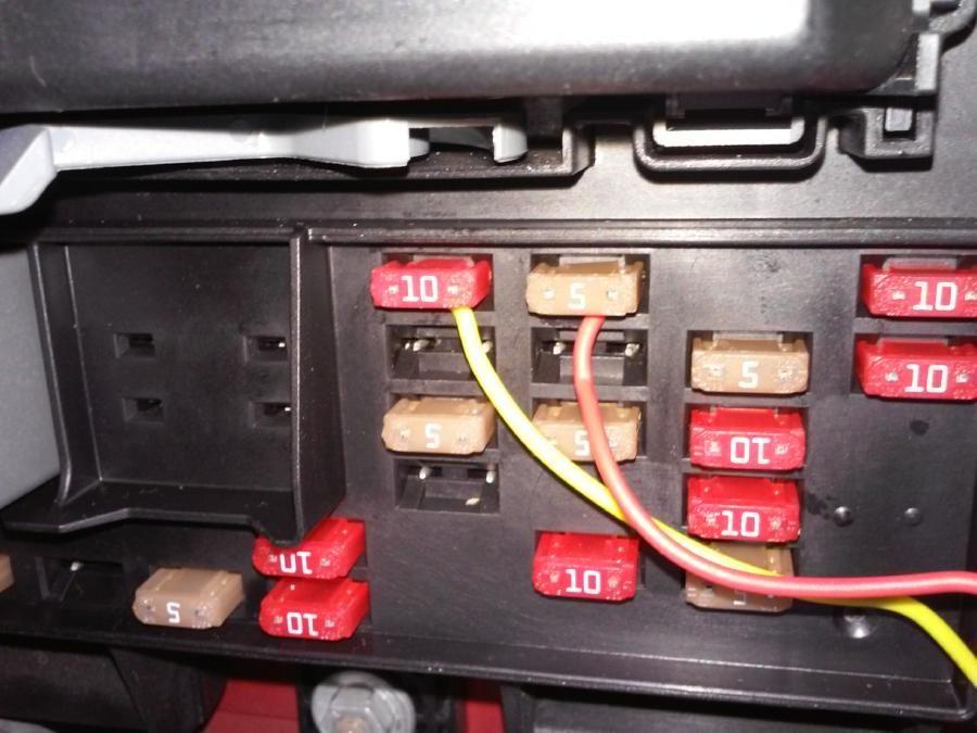

B+ (Yellow) & Ignition Power (Red):
The wires are on the power side of the fuse, and each wire has it's own 10A fuse.

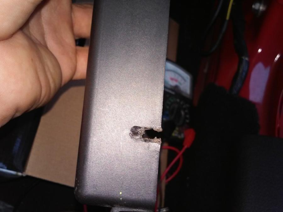

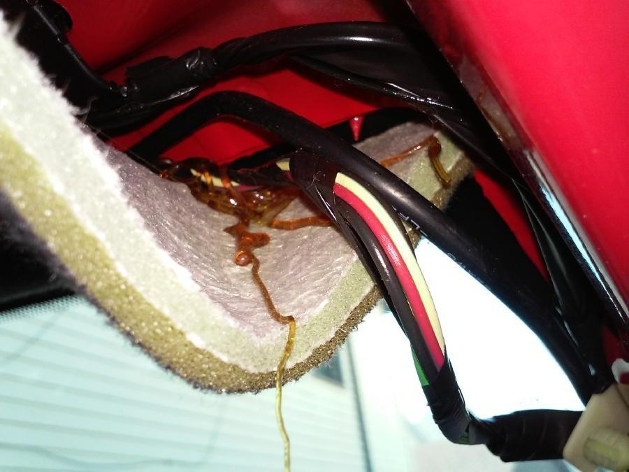

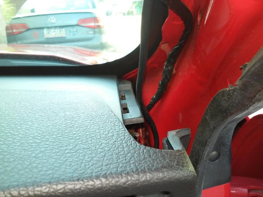

Cut a slot in the cover for the wires to exit:

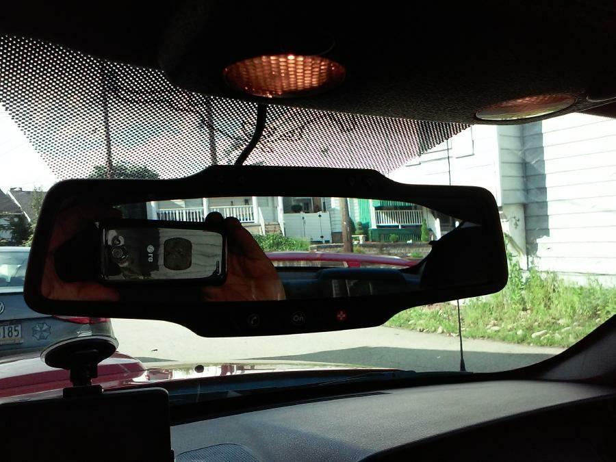

Cover on, wires through:

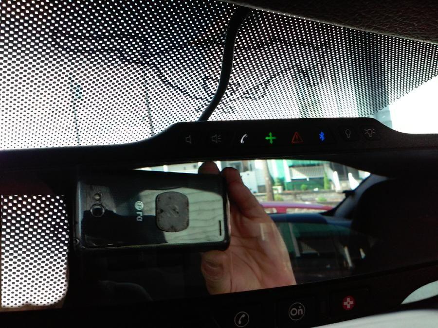

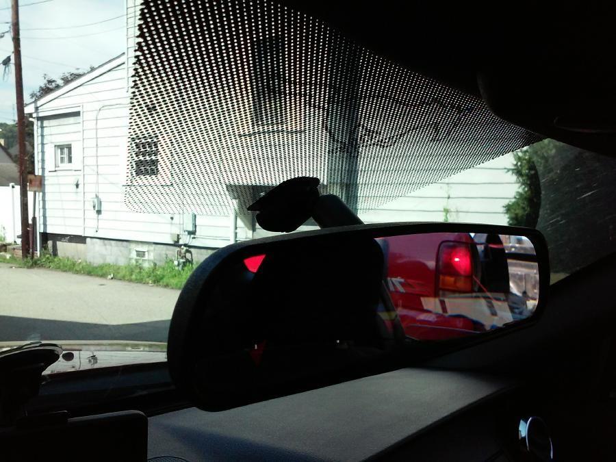

Powering Up:
Done:
