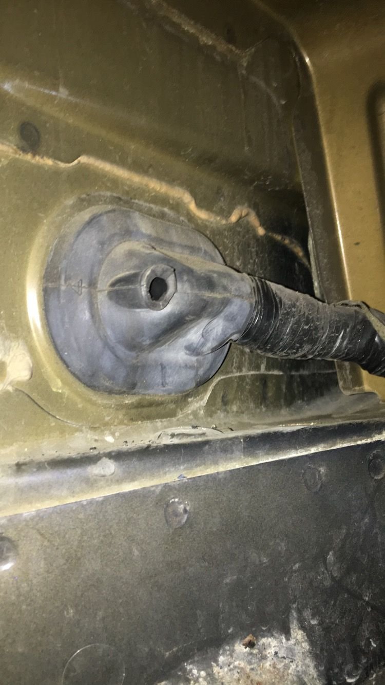

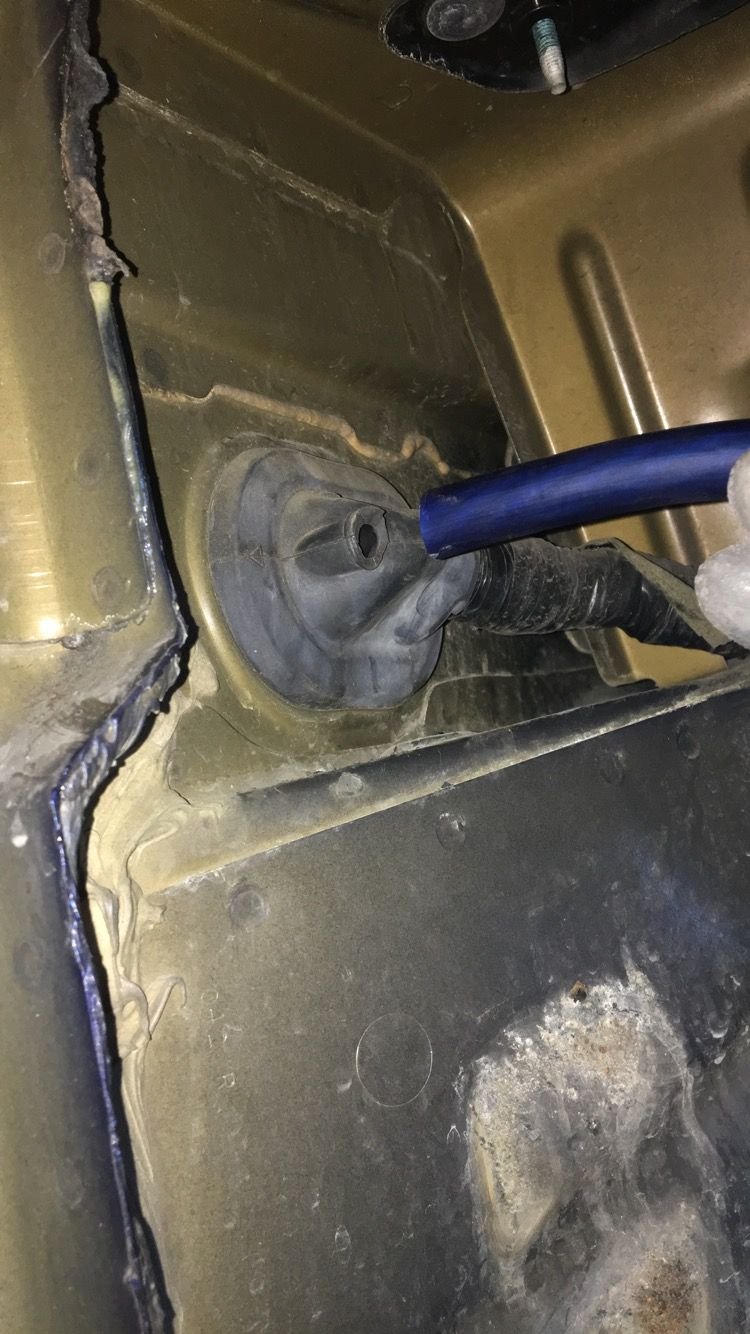

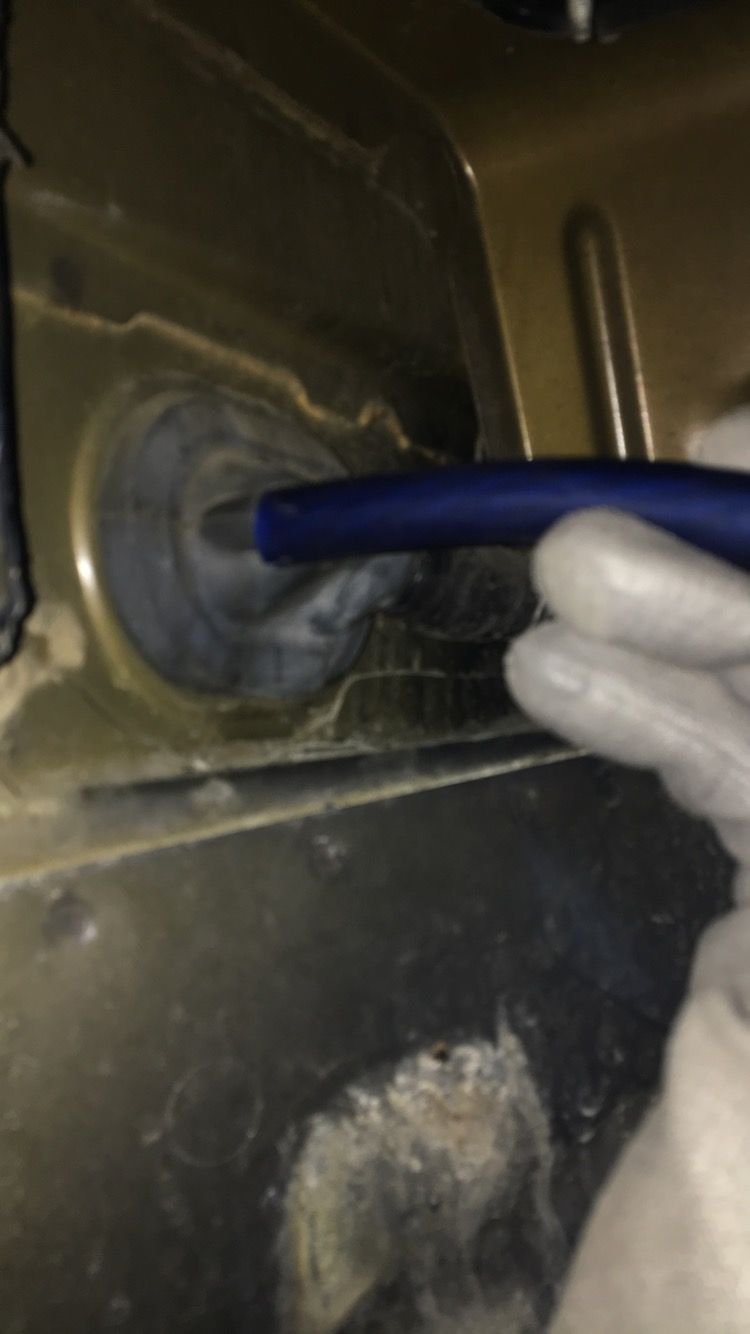

I doubt you need "0" gauge wire for the amp you're installing anyway.
If you WANT that wire, then you have to make another hole, OR?
You need to shave the front down to like a pencil, with a blunt end on it.
Then, use silicone spray to get it through, then while pulling it, keep
lubricating the insulation... 0 gauge is overkill, your electrical system
would not even handle an amp that would require a wire that thick.
That hole will stretch some, so you need silicone spray to slide it
through, IF that will even work. If not, go with 4 gauge.
2 gauge can handle 150 amps over 14-22 feet...
For your application? 8 gauge to 14 feet, or 4 gauge beyond 14 feet, for an
amplifier requiring 65-86 amps. You can still get away with 8 gauge from the
engine bay to the trunk, for 50-80 amps.
Also, the wire may be small, and with the insulation be 0-gauge, they fool you
sometimes. 0 gauge means the wire strand is that size, not the wire including
the thickness of the insulation. I have seen wire that is an 8th of an inch round,
with a 1/4" of insulation around it, and they say it's 8 gauge... No, the wire is like 12
gauge with a ton of insulation.

Thanks you for the info! I will look to use 4 gauge instead of the 0 gauge that I purchased.
