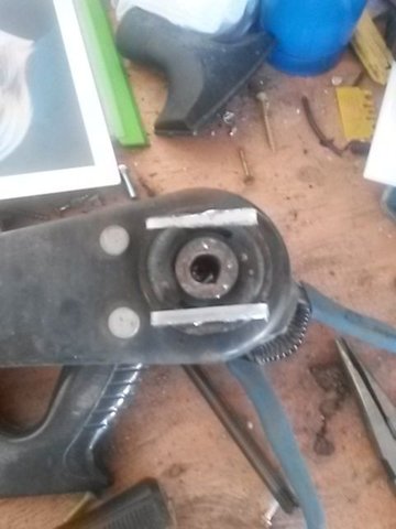

[QUOTE=CincyGT2009;7432945]Assuming it is the stabilizer bar bushings, what would you use to lube them and is there something that can be sprayed rather than disassembling everything?[/QUOTE
The stabilizer bars walk across the forward bushing until they rub on the bracket. I took them off and knocked the bushing back in. Then I welded straps on the other side to keep the bar from walking over.
Straps hold bushing in
