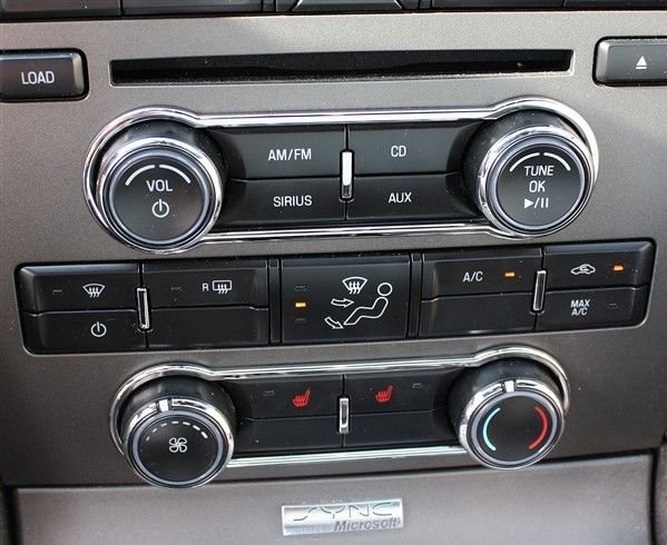

What's going on everyone? first time poster here. I have a question about the 4 buttons in-between the climate control *****. I was wondering if I could they could actually be used. I have lights mounted in my grill (did it for fun, actually looks pretty good) that have a switch in the engine bay. I was hoping to make it a little easier to access and look neat (no toggle switches or anything hanging around). Also for future projects like the electric exhaust cut out. thanks for your time and input.

not without significant hacking. those don't have any switch hardware behind them.

But I could put my own button behind them? Are they able to move?

You might want to look into the heated seat controls, those are real buttons you can probably be able to make work.

do they move when you press them?

I dont think they move, but you could possibly buy the whole dash piece from someone that installed an aftermarket radio and doesn't need the parts anymore. You would need to figure out quite a bit on your own, but I bet that it's possible to put moving buttons there. You could also install a push button in the center console, or under the dash somewhere.
