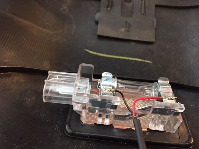

Dont just tap into the 12v wire from the existing lamp; apparently, these are ground switched. If you use the tempting and convenient ground just to the side of the existing lamp, you'll have your aftermarket lamps on all the time.
If you're going to snip wires to make this work, you'll probably have to cut into both of them.

I just roughed up the housing and soldered a couple of wires to the trunk bulb.
Works great. Now I can see I need to clean my trunk.

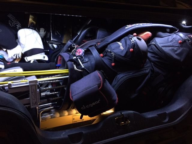

I also replaced that old bulb with a new LED bulb. It runs SO much cooler and matches the led lights I put on top of the trunk. It's really nice.
I tried a couple of different adhesives to make that LED strip stick to the metal on the underside of the trunk. The only thing that ended up working for me was some clear silicone, and I used a lot of tape points around it until it cured. That was a bit challenging because the electrical tape didn't want to stick to the metal either. I ended up just using a LOT of it, and it held long enough to do the job.
