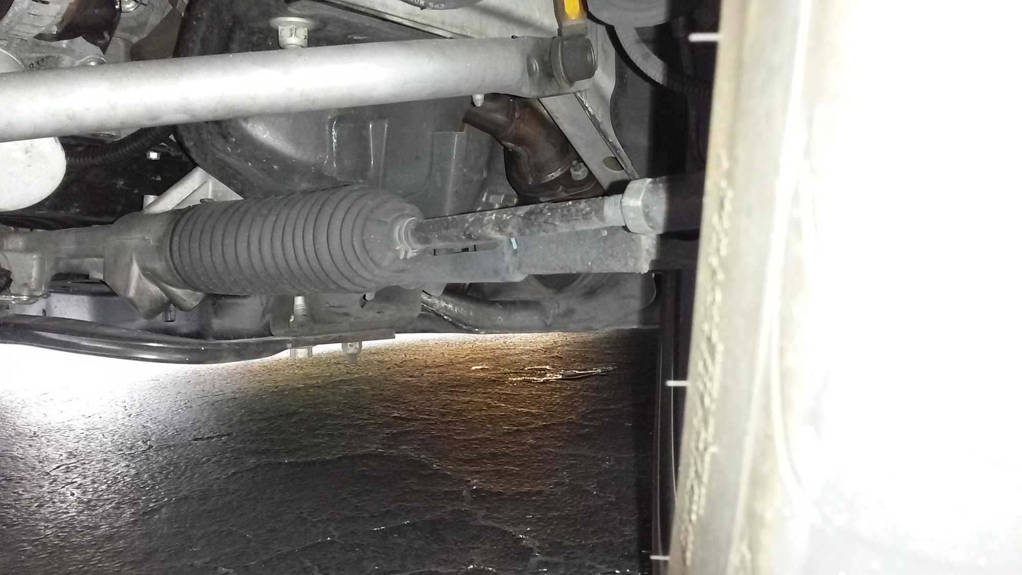

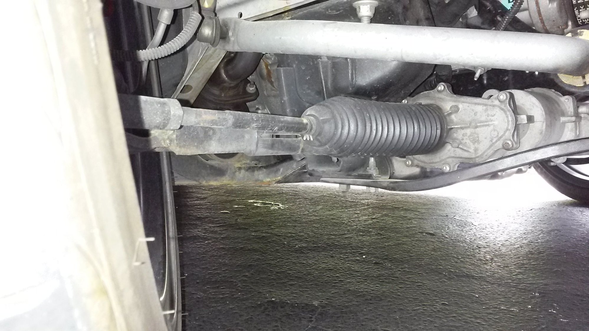

The front tires are also stock circumference. I read that different front tire sizes can affect EPAS and front tire sizes other than stock with EPAS are a bad idea.
255/35/r20 in front that are Pirelli Ford stock with 25,000 miles still good, but worn. 275/35/r20 in back that are Firestone Oval 500 couple months with 1500 miles max.
Pirelli have a rep for Tramlining on the forums.
lowered an 1" to 2". Forum can slightly distort. Click on pic to expand.
suspension

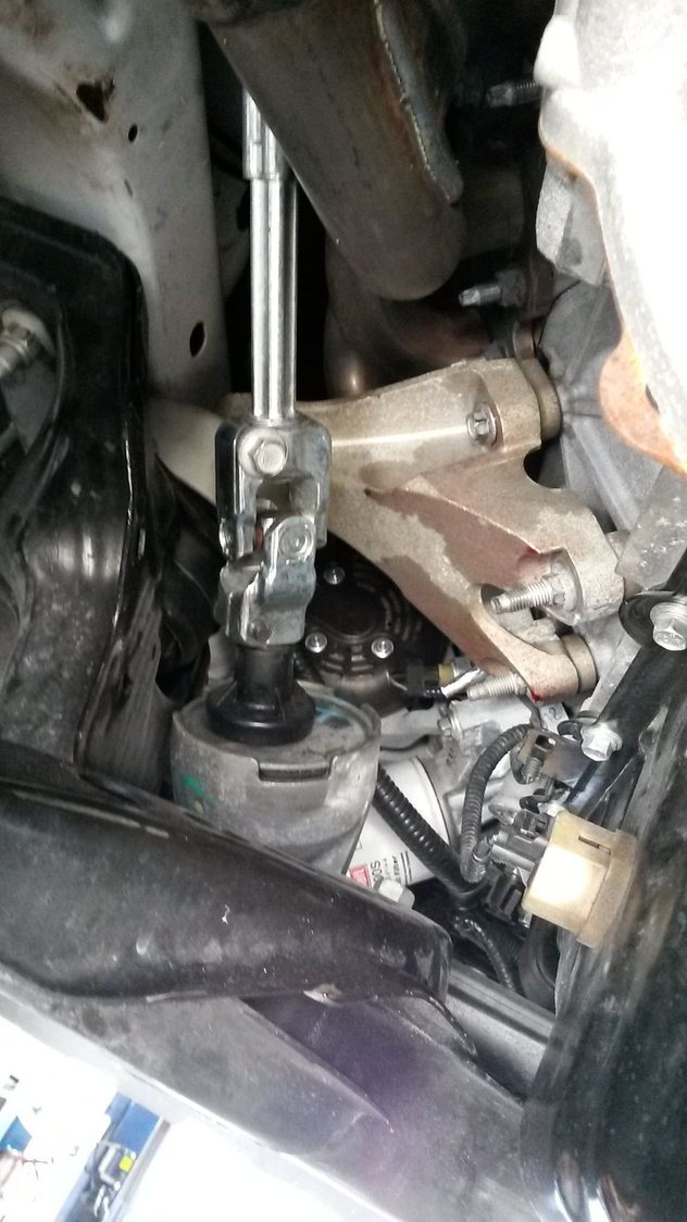

EPAS joint and steering shaft in silver. This is the part they replaced using a mallet to separate the joint and get it off.
front left
front right

It seems that firmer than OE LCA bushings give the OE EPAS fits - maybe unexpected feedback throws it off into a logic loop or something. This is a real problem - Ford knows about it and does not offer a reflash fix. The only "guaranteed" solution for those with poly or whatever other aftermarket material LCA bushings has been to swap out the production EPAS for the FRPP EPAS unit, part number M-something or other, which does not include the ANC or DPC logic. The guys at Vorshlag know a whole lot more about this than I do.
It's a warning flag to me that if the production EPAS is that sensitive to things like bushings, beating on it or on things connected to it might also be a bad idea, or that there's a different problem possible in the production EPAS that's as yet undiagnosed.
