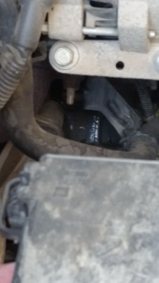

My 2008 V6 has a major water leak below the alternator. What is leaking...

plastic thermostat housing, 99.9999% sure. very common issue with the V6 cars. a few places offer aluminum housings but they are a bit more than the stock plastic replacements, that will fail again in time. good luck
