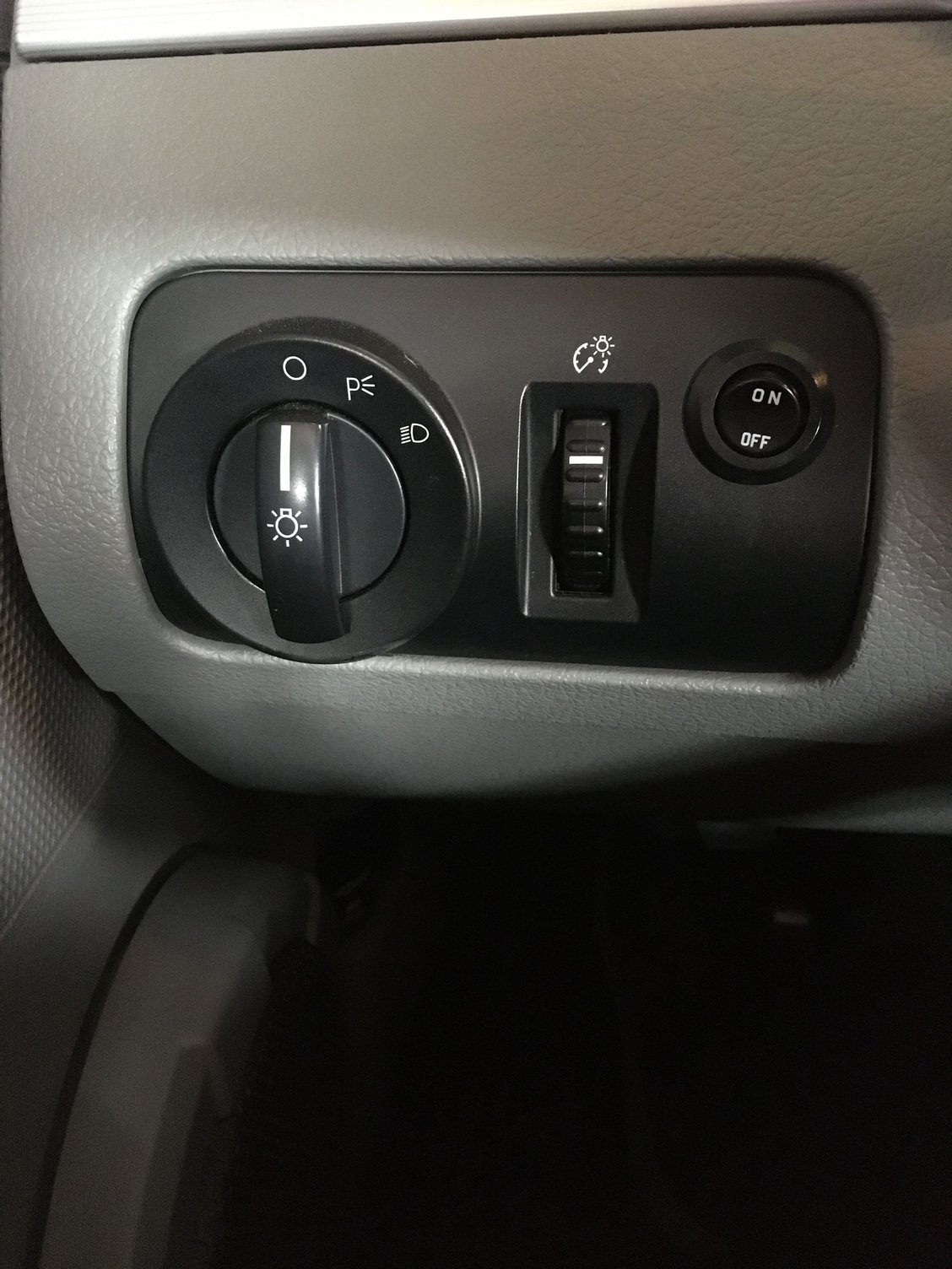

Any thoughts on what this on/off switch might be for on a 2005 V6? I thought maybe the fog lights, but no. Previous owner didn’t know either.

I had one like that on my 2006. Installed it to control the line lock. Try stepping on your brake and turn it on, then take your foot off the brake, to see if your front brakes are locked.
