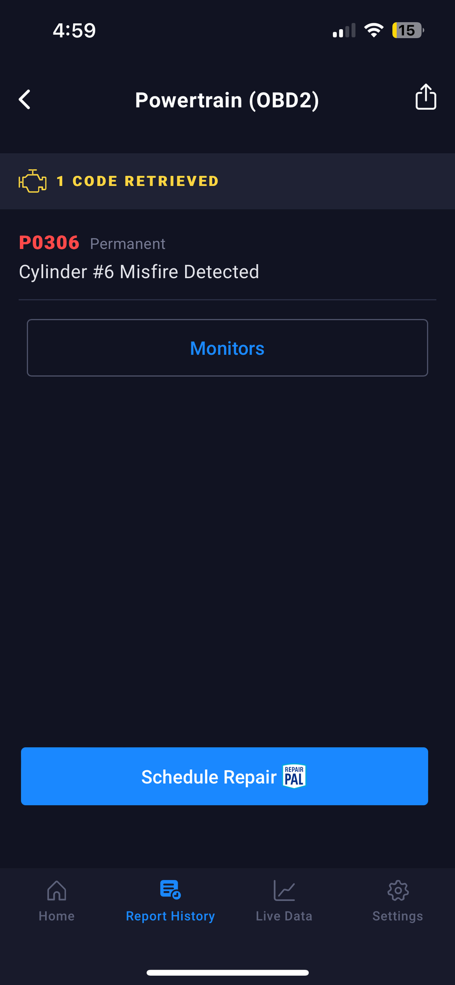

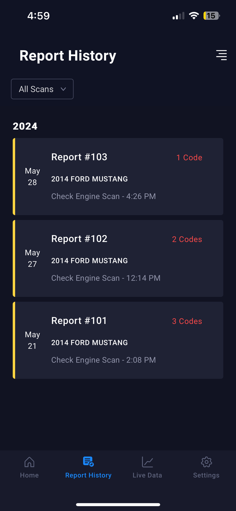

My idling has been rough for a bit, I’ve changed the spark plug and the fuel injector, I had 3 p0306 codes at first then 2 after the spark plug and now 1 after the fuel injector. The car starts good and runs perfect for a little but once it gets warm it starts to gurgle and you can feel the extra vibration from the misfire.
