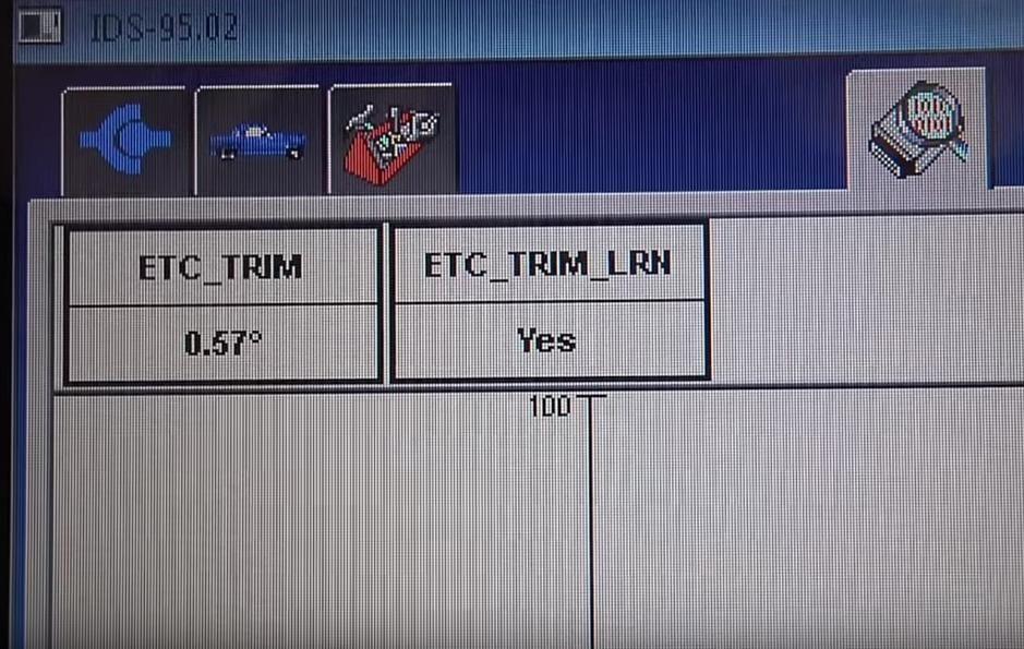

When at operating temp, wait about 5 more minutes so it learns cold and hot idle trim values. A FORD scan tool will verify it
is learning, and has has learned the cold and hot idle trims, but it not needed (why you wait after it's at operating temperature),
it is in the parameters for the throttle angle. When at full hot, the throttle trim should bottom out at 0.57 degrees HOT, which is
shown with the scan tool. Then, all your acceleration values are based upwards off the set hot idle angle.
ETC_TRIM will display where it is, and ETC_LRN will set "Yes" when it has learned the base idle trim. It can happen as early as 0.61, but
as you wait, it will go down, and should set at around 0.57.
After about 5-10 minutes from HOT.
It would also show you where it is at (ETC_ACT), and where it is desired (ETC_DSD), the desired should not be more than .05
degrees ahead of actual. SO, if it's at 1.87, but DSD shows 1.90, then you're good.
