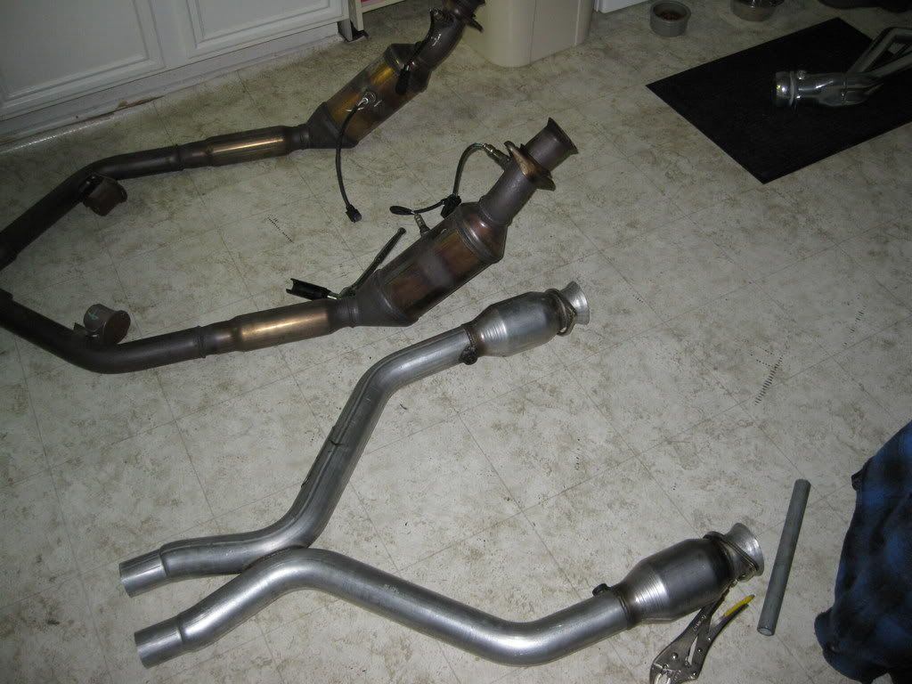

This is my BBK shorty catted x pipe compared to the factory catts. I've read the factory catts flow great compared to several years ago. So if your thinking about adding shorty headers and changing to high flow catts, isn't going to be worth the money or time. Again, just my opinion
